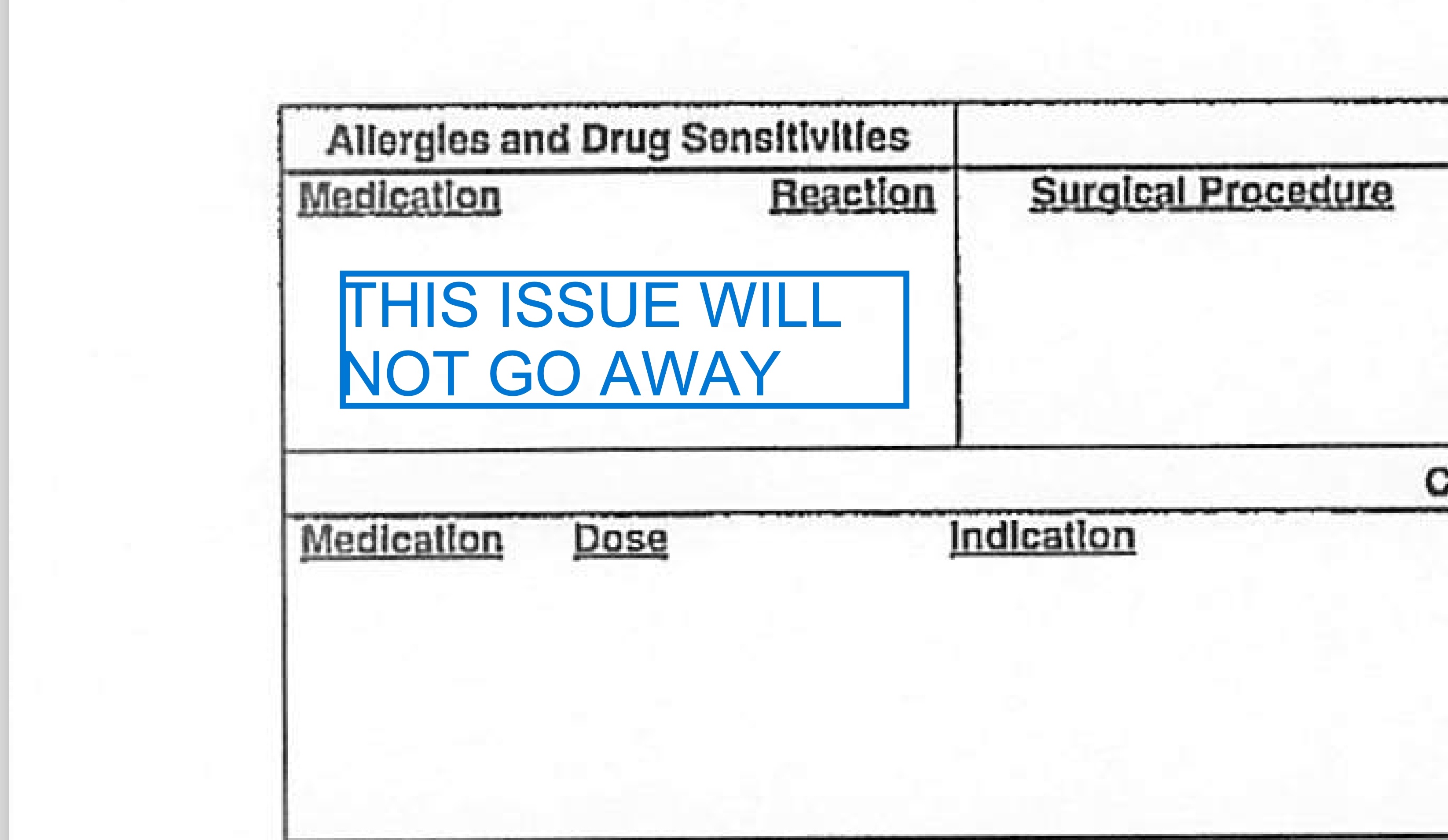

    I did all that and it still has the box.

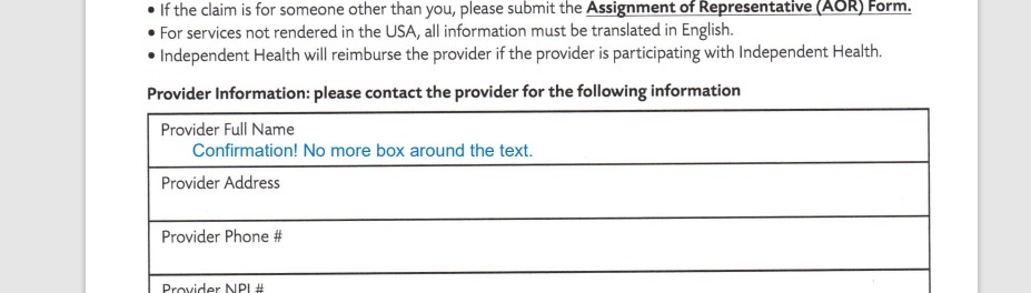

    2025-02-11T12:38:03+00:00
    Thank you, Arthur, that works! I enabled the New PDF Viewer in edge://flags, then added text and no box showed up! I also confirmed that after saving the document, setting the New PDF Viewer back to Default, and opening the document back up, no box showed up, so my document will look clean even for others that don't have this enabled. Success!
    Thanks again,
    KB
    2025-02-12T20:53:11+00:00
    Hi Arthur,
    that did not work for me- any other options?

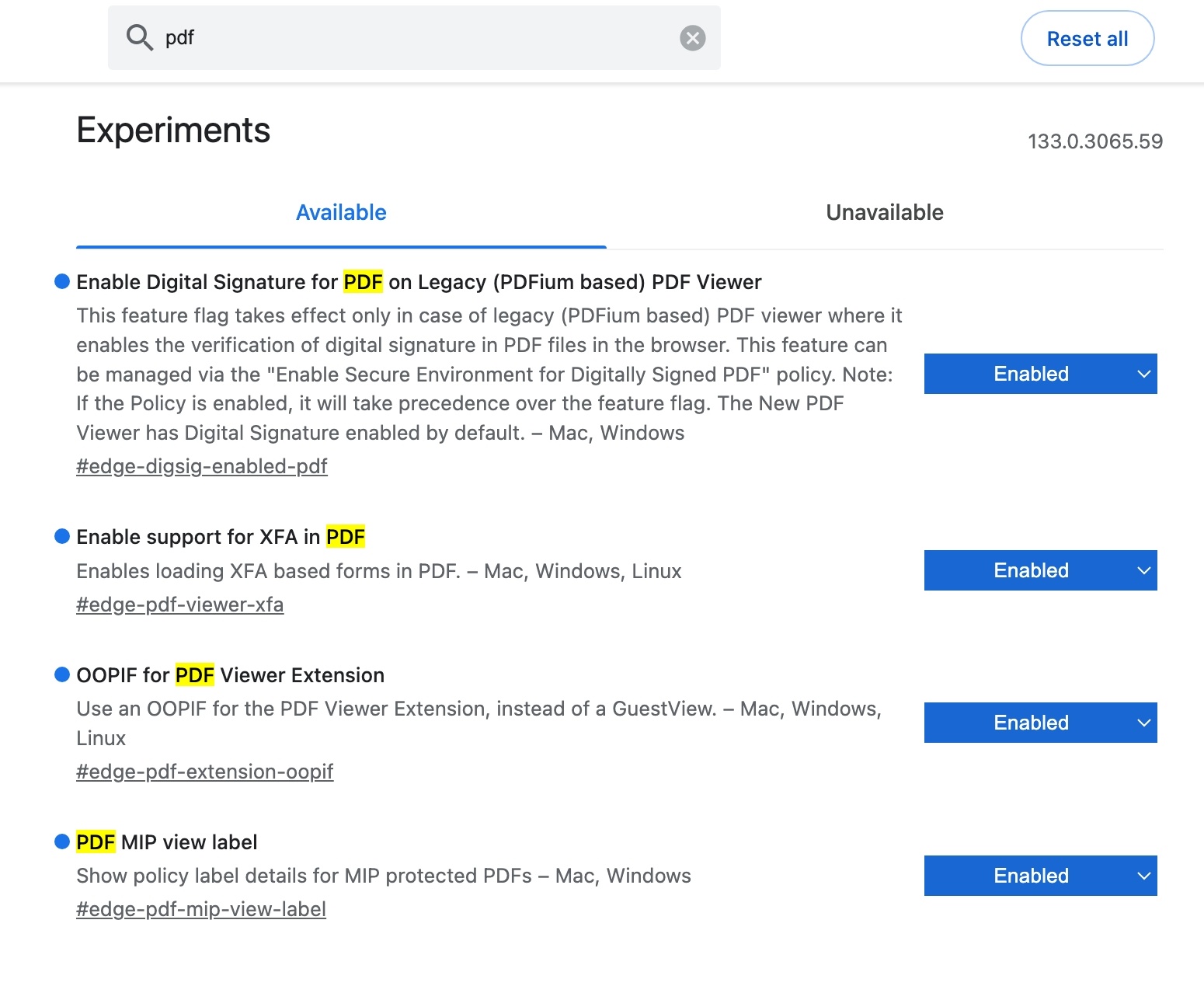

    2025-02-13T21:40:33+00:00
    I have verison 133.0.3065.59 and the issue still persists. I have tried the above solution and it is not an option for me. I have tired toggling each option off and on and nothing changes the text boxes are still present. Please help me fix this-
