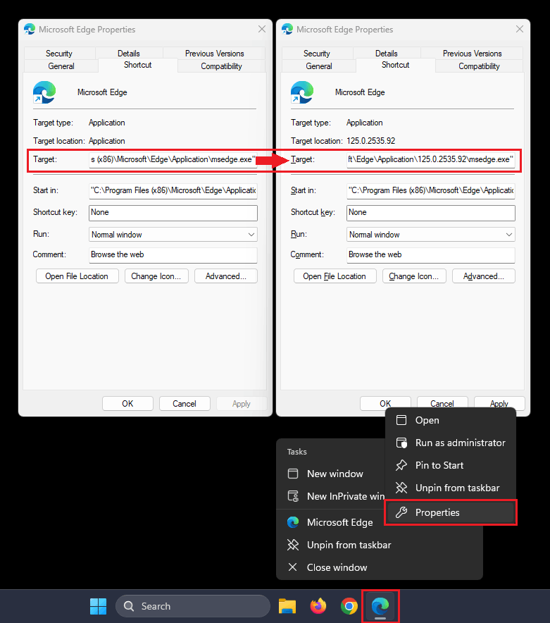

    2024-06-07T08:06:27+00:00
    What worked for me is chaning the Target in the Edge shortcut on my taskbar from "C:\Program Files (x86)\Microsoft\Edge\Application\msedge.exe" to "C:\Program Files (x86)\Microsoft\Edge\Application\125.0.2535.92\msedge.exe"
    The disadvantage is that after the next Edge update, the path needs to be changed again to the version newer than 125.0.2535.92 or, hopefully, reverted to the original path ("C:\Program Files (x86)\Microsoft\Edge\Application\msedge.exe") - but for now it works!
