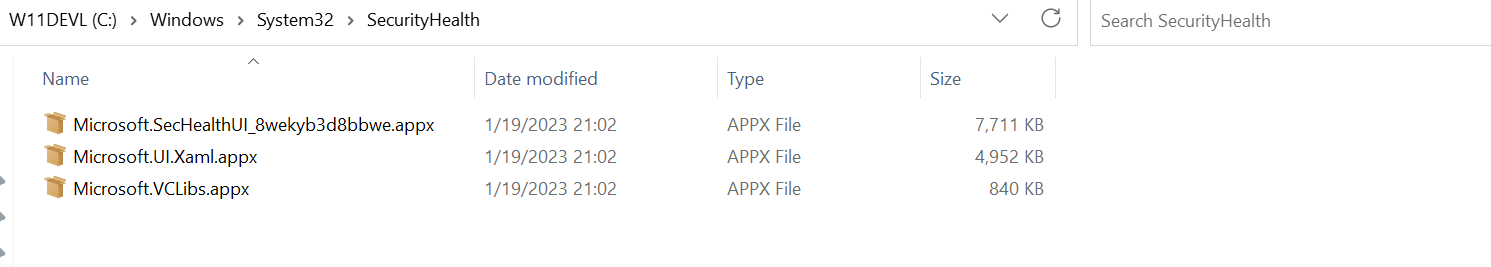

    Check the folder below and you probably only have the 3 files from Jan 28th. 😎
    See the difference below on this machine, only 3 .appx files from Jan 28th, 2023, and nothing else. 🤷‍♂️
    This one never got any previous KB5007651 updates.

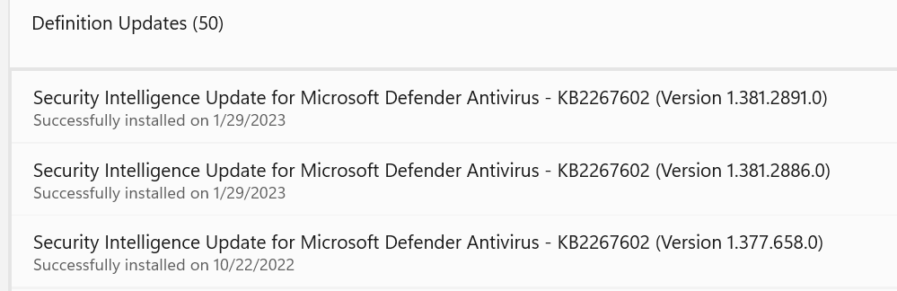

    And another PC updated by W.U. from 25227.1000 to 25284.1000.
    No sign of any of those 2301 kb5007651. Really weird criteria for testing. 😎
    Why on some machines and not others? Perhaps MS pulled those back, who knows? 🤷‍♂️
