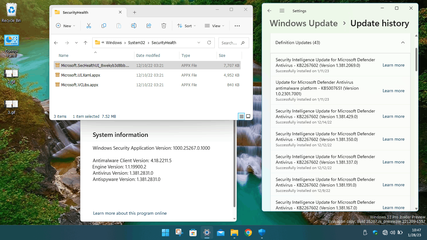

    2023-01-28T19:03:20+00:00
    Anyway, you show that you already had the problem on 1/11/2023 with Build 25267, which shows security version 1000.25276.0.1000 🤐
    Upvote Pauli's FBH report and add your comments.
    Good observation, I didn't notice that before. I upvoted and commented yesterday.
    I deleted the folders and reinstall 25267 without network and updates paused, everything was fine until I went online and deja vu all over again, still updates paused. 😒
    This backup is not good to me anymore, going to RP for the time being until they fix the resolution bug at which point I will start a fresh Dev build.
    Thanks!
    2023-01-28T18:38:19+00:00
    Are you saying that both the 7001 and 24001 are coming is as soon as you connect to the internet.
    I thought you had the updates suspended?

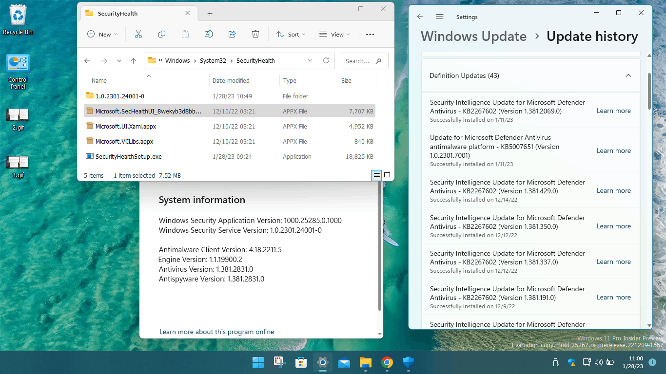

    Hi fg,
    I was wrong, on a newly restored 25267 I have 7001 & KB5007651 from 1/11/23, this is with network disconnected and updates paused.
    A few minutes later with network connection, 24001 shows up even with updates paused.
    Notice the new KB5007651 doesn't show in history yet and icon with yellow mark.
    Another difference with what I see, I don't get 24001 while updates are suspended, only after I resume. 🤷‍♂️
    Still unclear how MS picked your machine and many other ones to install those KB5007651 updates.
    One of my Dev boxes is never getting any of those KB5007651, but the different behavior is still a mystery. 🤬
