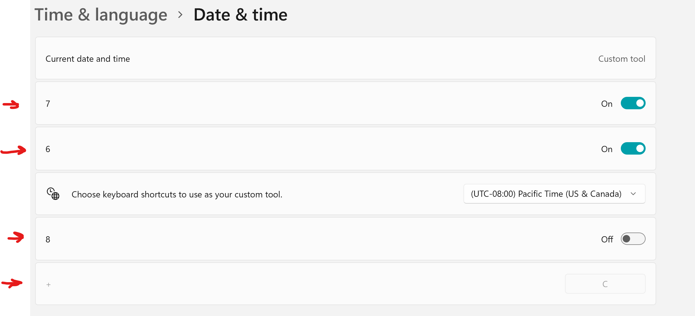

    I think I just proved my point, rather than restoring the backup from yesterday, I used PowerShell to remove the last package that was updated from the MS Store and that eliminated the problem of the incorrect Time & Language page, which now looks normal again.
    Hi fg, good 🕵️‍♂️ job!
    What is that App for? some language add-on?
    Local experience language pack, whatever that means, I installed the same on another box and got the same bug.
    Not sure why it was on automatically on the failing box.
    In my case it is en-US, so it should be pretty normal.
    I don't have that App, never seen it before.
    You can try it it is in the MS Store, then you can remove it with P.S. 😉
    2022-01-14T04:16:37+00:00
    Hi Sibro,
    I think I just proved my point, rather than restoring the backup from yesterday, I used PowerShell to remove the last package that was updated from the MS Store and that eliminated the problem of the incorrect Time & Language page, which now looks normal again. I think I'll make a separate FBH report with the details.
    Another crazy MS bug! 🤐
    Get-AppxPackage Microsoft.LanguageExperiencePacken-US -AllUsers | Remove-AppxPackage
    Reinstalling the App brings back the problem.
    Added the same language pack on a second machine and got the same problem.

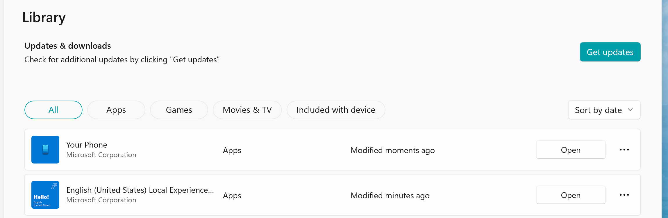

    2022-01-14T03:43:32+00:00
    Hi Sibro,
    I tried crashing the settings app with the HDR settings, but that did not reproduce the bug on the Time & language page.
    But I think I just reproduced the problem right after getting these 2 updates from the store, the incorrect Settings page for Time & language showed up again right after that.
    I will restore again and see if it is consistently repeatable. 😎
    The English (US) local experience may have something to do with it?

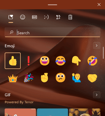

    Ok, well, I now have 533. I am glad, happy to have Text Input, again. I liked it 😊👍👍
    I've decided to use this one
    DL & install of 533 went smoothly and it seems to be running nicely, at least, so far.

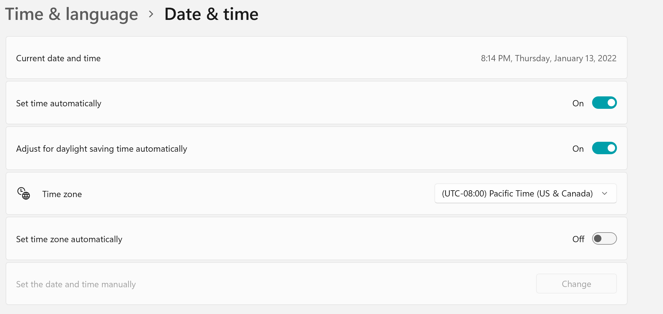

    2022-01-13T10:19:03+00:00
    Must have something to do with the time zone, because mine shows correctly
