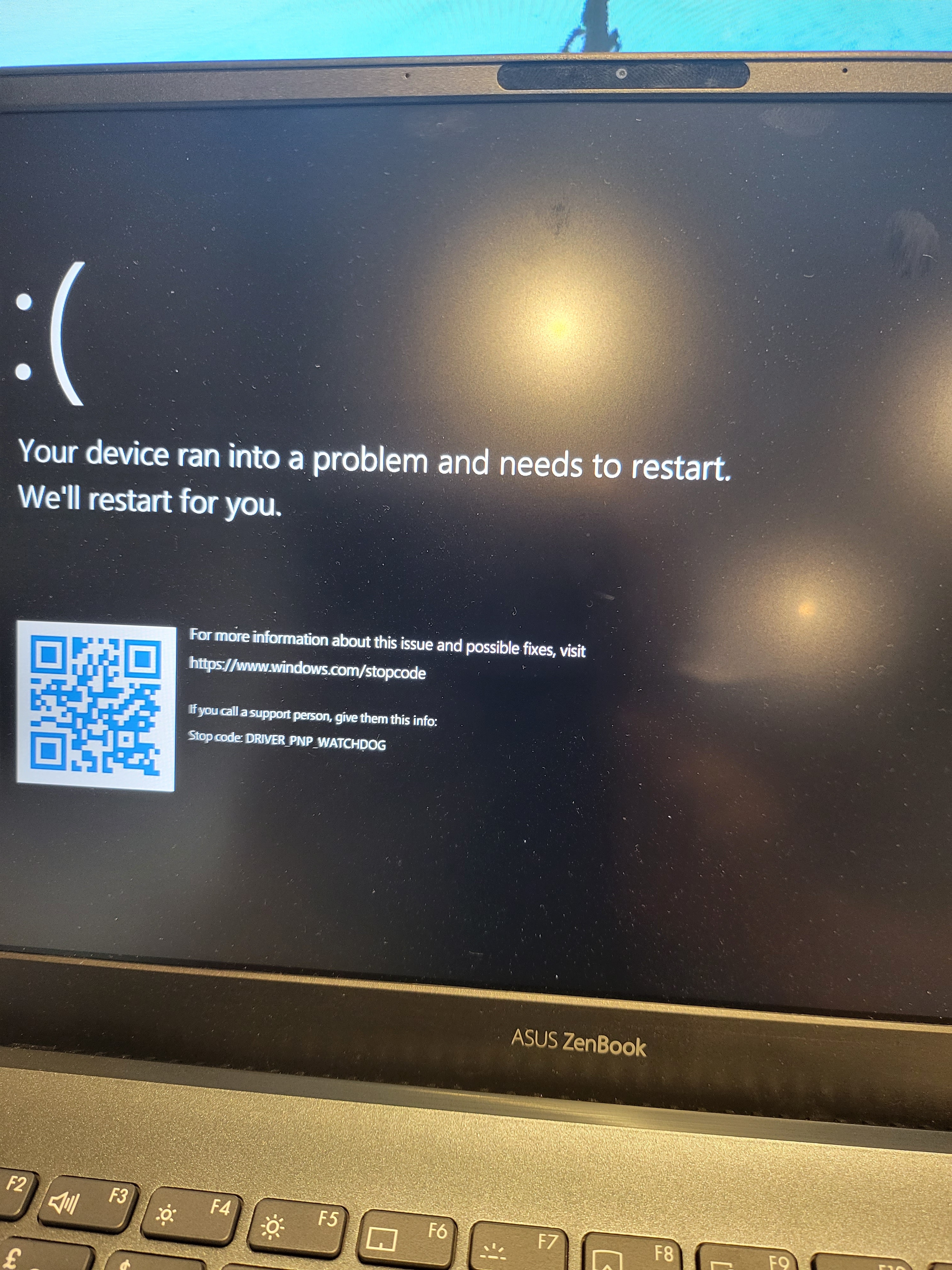

I have an Asus Zenbook. After/during the latest Windows 11 update, I am no longer able to boot into windows. I get Stop code: DRIVER PNP WATCHDOG BSOD, and sometimes INACCESSIBLE BOOT DEVICE. I can't get to the recovery environment, although BIOS is still working.

    The order of events were:
    1. Upgrade the OS
    2. Laptop requires a restart
    3. Driver PNP Watchdog Error
    4. Laptop tries to run auto-repair
    5. PNP Error Again
    6. Steps 2-5 loop around

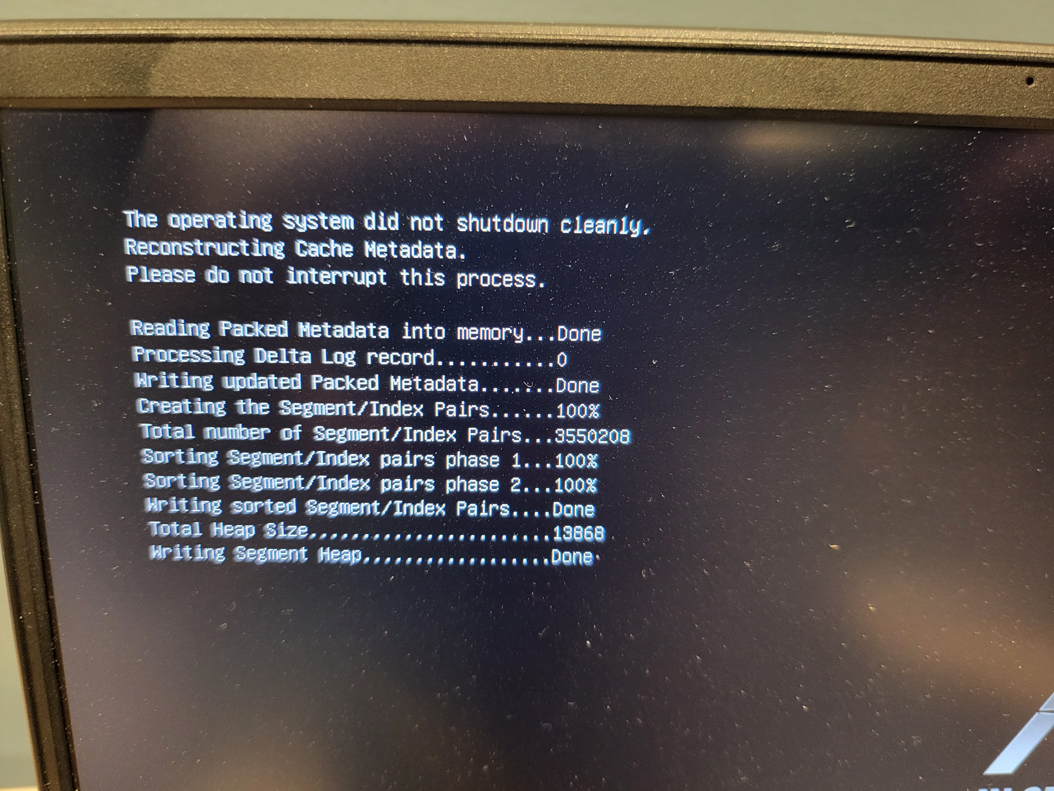

    7. Tried to reinstall Windows using the MCT (loaded on to a USB drive)
    8. No drives found
    9. Try to install the drivers
    10. Process starts, then after about 5 minutes....

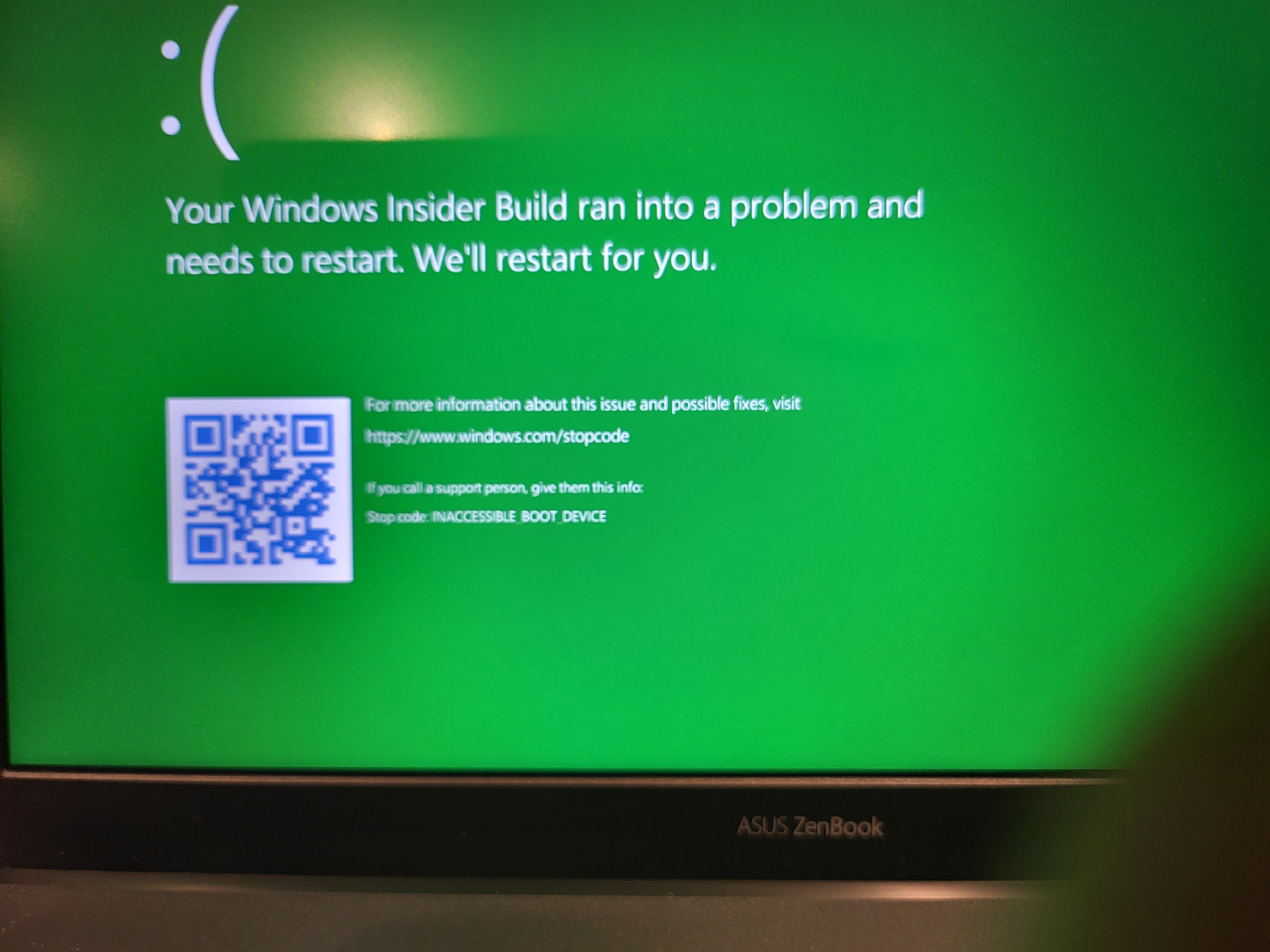

    11. Get either a Driver PNP Watchdog error, or an inaccessible boot device error (see below)
    12. Ensured the SSD is seated properly in the device. It is, and the drives are recognized correctly in the BIOS
