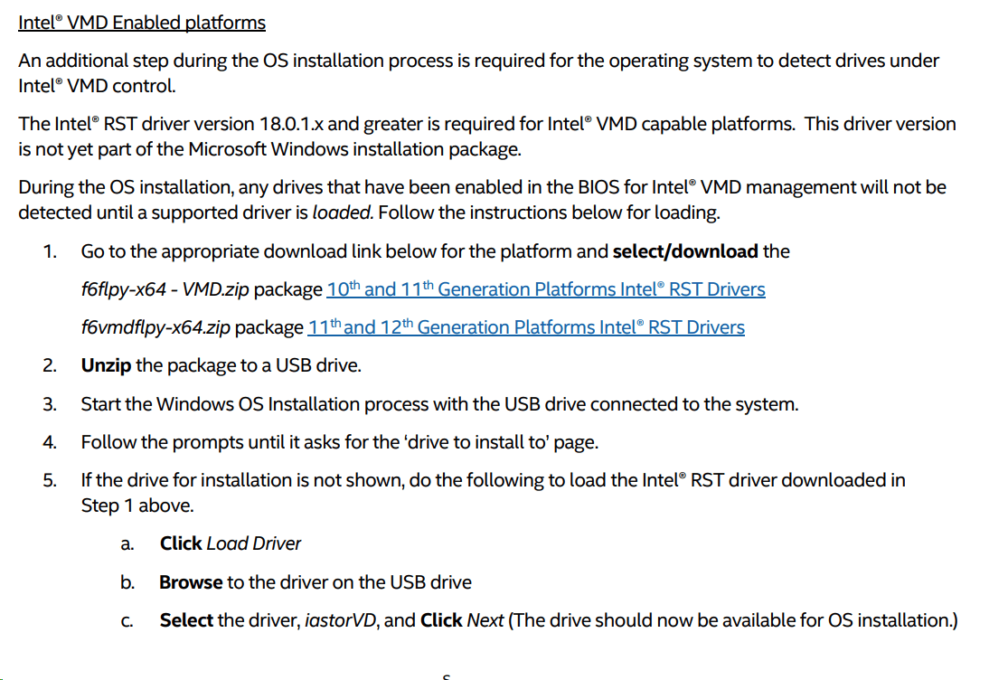

    "I also used the drivers from that link (non-VMD) "
    You want VMD enabled in the bios, also you want VMD drivers and make sure its for the SSD H10 series, all my links are but always worth checking*.*
    Your hard drive is **** Intel® Optane™ Memory H10 with Solid StateStorage and the driver for this is **** Intel® Optane™ Memory H10 with Solid State Storage ****
    read through this and let us know if any of it doesn't make sense Intel Optane Memory H Series Installation & User Guide
    I read the driver update which is supposed to have a fix for your DRIVER PNP WATCHDOG error.
    Note
    The Intel® RST VMD driver should not be uninstalled/removed after installation. This could result in an Inaccessible Boot Device blue screen and potential data loss.
    VMD device is always enabled on a platform where VMD device is deployed. There is a possible configuration where VMD does not own any device. This is an empty VMD configuration. As a result of this, the RST VMD driver should always be installed on such a platform to avoid a yellow bang device in Window’s Device Manager
    use iastorVD file , have you used 7z or Windows by unzipping a file download as I would download the zipped package, extract to a USB stick so when you need to install the driver.
    Hopefully the harddrive will show up once this driver is installed
