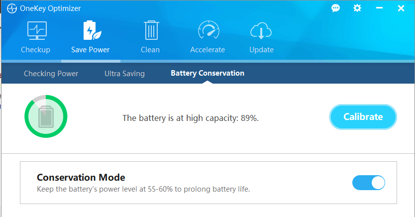

    2022-01-01T23:13:12+00:00
    Suggest you download & install Lenovo OneKey Optimizer, it's old but still works on Windows 11.
    Amongst other tasks, this handy utility lets you calibrate the battery (beware it could take hours), maybe after a good calibration it will start charging again. Also you can enable "Conservation Mode", Lenovo's recommended 60% limit to prolong battery life until you need a full charge of course.
    I've been using it like that since 2018 and my battery is still at 89% capacity.
