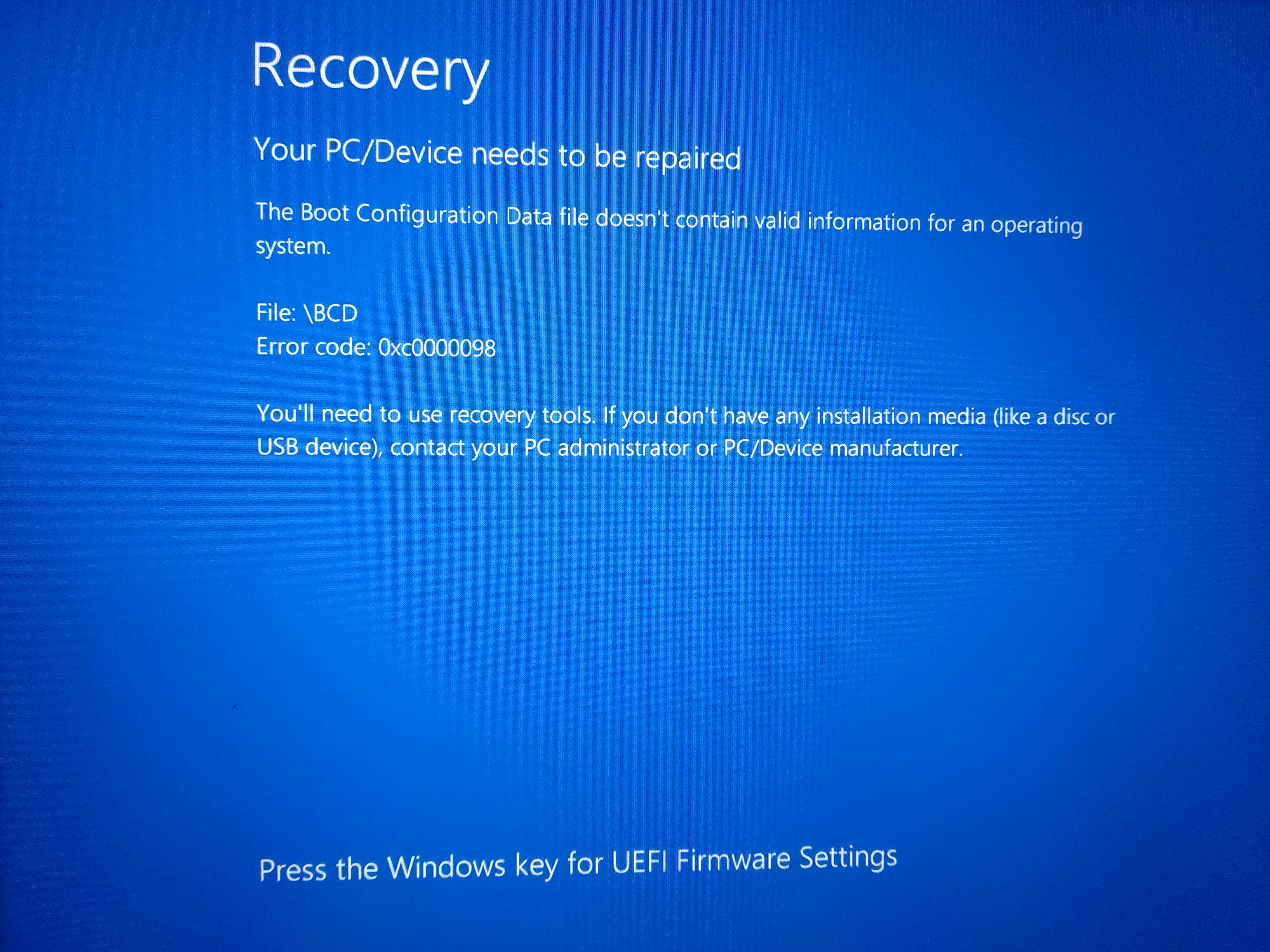

Blue screen error after downloading software update. File:BCD Error code:0xc0000098
2019-02-26T22:12:31+00:00
Erro code 0xc0000098 blue screen on surface go after download of software update
Surface | Surface Go | Install and update
2019-06-21T00:35:50+00:00
Well, I was able to fix my surface although will now have to re-install a bunch of things.
A few tips for those wanting to self fix.  Download the Surface image and put onto a USB.  You will need a USB-C to USB-A adapter if you have a Surface Go.
If stuck in the Blue screen of death loop, go to the Surface UEFI menu by pressing the Windows Key.  In boot order, order the USB higher up than the Windows Boot.
Boot from Surface, then follow the instructions provided by microscoft.
i.e. Select Keyboard
From there -> Troubleshoot, recover from device, skip key entry, recover vs. clean wipe depending on your uses
Now, I think this problem is related to Windows Update and surfaces since it's happened to a bunch of people.  Hope microsoft can look into this.  A bit nervous to install windows updates again

    I have the same error, after following to get update on my surface go, when it shutdown it doesn't enter the windows and have this blue screen.
    My location is in Indonesia, where there is no support center to visit.
    If I choose to using USB stick to recovery, what should I do? Is it save option to recover my data?
    Thank you.

    If you have the BCD error, you MAY be able to repair and save your files. If you
    need to use the recovery image to completely reimage your Surface, you will lose
    your files. If you are in the US (there are also 5 stores in Canada and 1 each
    in London, UK
    and Sydney, AU) you should go to the closest physical retail Microsoft Store
    https://www.microsoft.com/en-us/store/locations/find-a-store - they can assist
    with this.
    2019-08-10T19:51:00+00:00
    I mean off my Surface Go, not off the USB stick
    2019-08-10T19:37:15+00:00
    Barb Bowman - will taking the USB recovery process wipe off all the files I have in my folders with my school work in them i.e will I lose them all?
