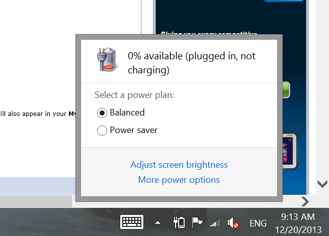

    2013-12-20T14:39:56+00:00
     t
    this is what mine looks like. and as soon as I unplug it it shuts off.
    2013-12-20T08:29:19+00:00
    Greetings,
    When your Surface Pro 2 is plugged in, can you get a small screenshot of the battery icon with the popup stating that it's plugged in but not charging?

    In my case say is this
    It has been days...
