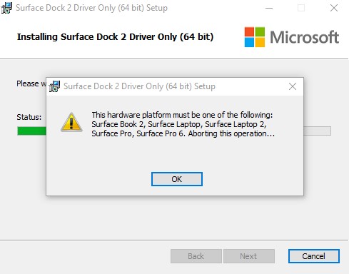

    2020-06-08T15:59:57+00:00
    Dear Janette,
    thanks for your answer. I installed the correct update file SurfaceDock2_SEMMforDock_Win10_17763_20.054.29469.0.msi
    As I found out in the meantime through different forum pages on the web, the problem is persistent since the Surface Dock 1. You can read it here in German: https://www.surfaceinside.de/surface-dock-updater-neue-version-neues-update/ Please see the comments in the bottom page.
    Obviously, the problem cannot be solved properly and it is also occurring in DisplayPort connections.
    So the last thing I will try is ordering a USB-C to HDMI adapter from Microsoft and connect the monitor with HDMI (I will lose the USB ports on the monitor then, but I have to cope with that).
    If you could please forward to the team, that cares for the Surface Dock, that they should provide a proper firmware update tool, where the user is getting better feedback if the update is done or failed, I would appreciate that.
    If the HDMI adapter does not help either, I will have to return the Dock and buy one from HP or Lenovo instead (although I would not like that).
    Thanks anyway for your assistance and have a great day! Stay safe!
    All the best,
    Julian.
