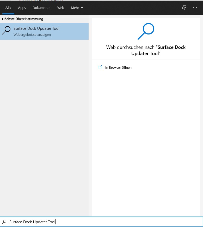

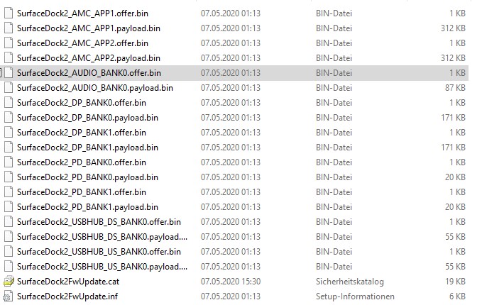

    The firmware update procedure is different, the issue (at least in my case) could only be fixed by buying an expensive Active USB-C to HDMI adapter... Native USB-C connection with a monitor still doesn‘t work from the Dock 2 and Microsoft did not give any helpful assistance nor released a proper firmware solution until now...
