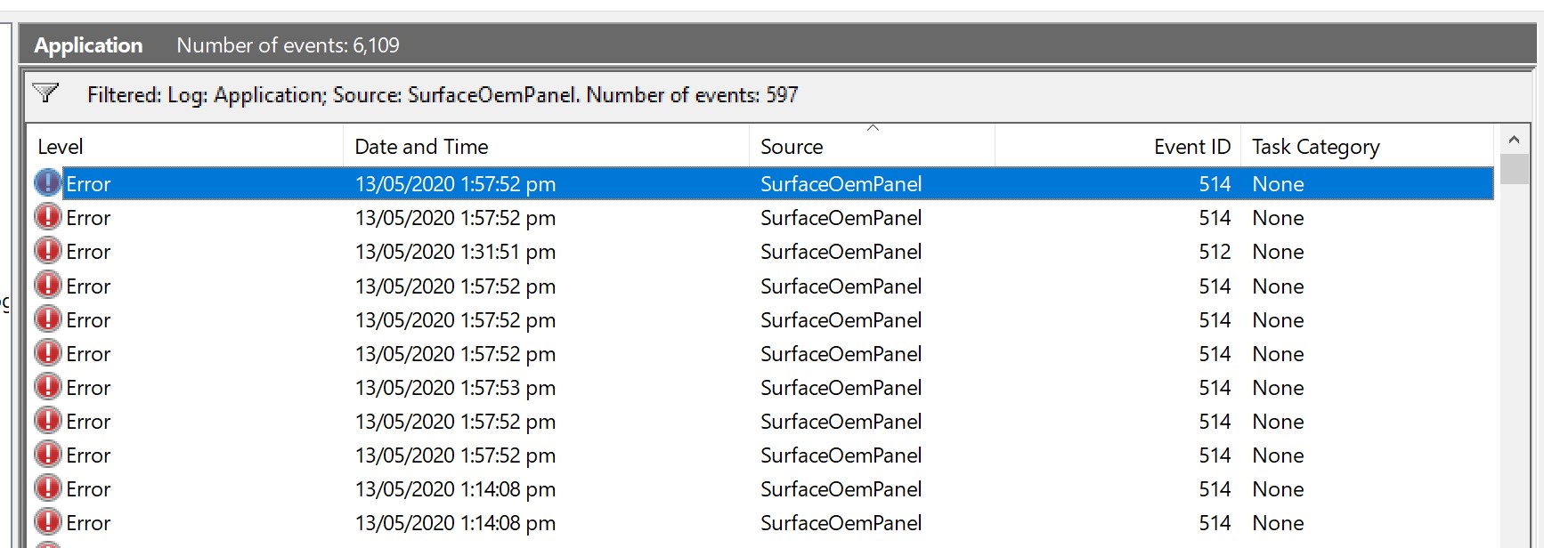

    2020-05-21T11:48:19+00:00
    I think you are right, I check my surface pro and get few hundreds of error logs
    I google it and found almost topics about Surface pro display which includes Surface pro X too
    So far so good with the not-updated Surface
    When it comes out of sleep it logs 1x Event ID 13 in the System log, and 6x Event ID 514 in the Application log, then it stops and works perfectly.
    Will use this for the next 4 days while i'm working from home, and see how it runs.
    2020-05-21T11:27:36+00:00
