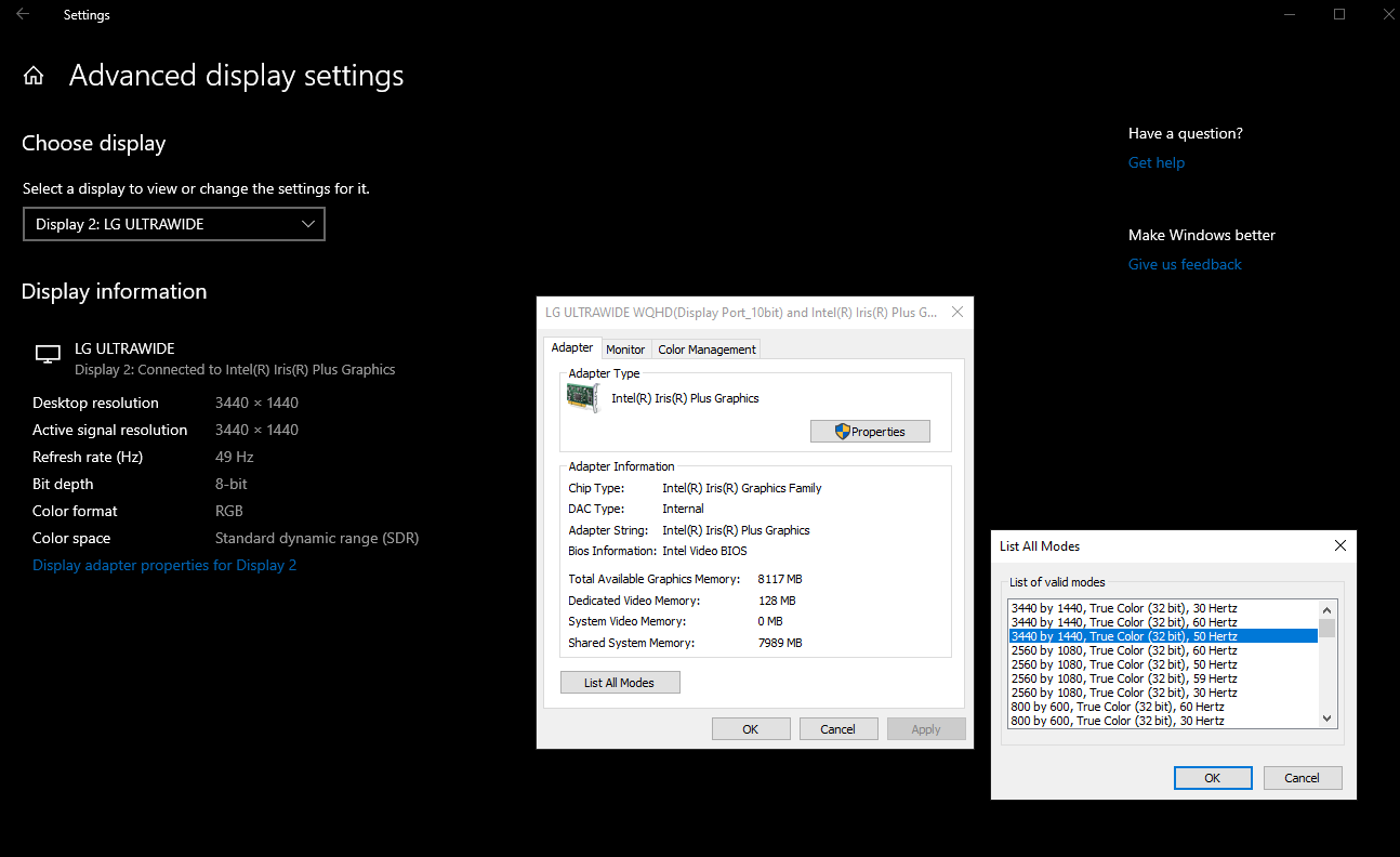

    Sadly, I just replaced my Surface Pro 4 (bulging battery and only a 90 day warranty with that unless you get a new one) and was seeing the exact same issue with one of two screens dropping out and coming back.  I'm running dual 3440x1440 ultrawide LGs on a Surface Dock.  What seems to have worked for me is this.
    1. Reset the Surface Dock, which is something I usually try first anyway. (still did it)
    2. Flushed the display with the registry file on this thread. (still did it)
    3. Validated that the Surface Dock was up to date (still did it)
    4. Manually updated to the latest driver (still did it)
    5. Finally, looked at all the modes and changed to one with a slightly lower frequency  THIS!!  (seems to work so far)
    Check all your modes.  Mine supports 3440x1440 @ 60Hz and that is the recommended mode, but it was dropping and coming back.
    Once I changed it to another mode that was supported, in this case 3440x1440 @50Hz, I have not seen the flicker.  It has only been a couple of hours, but it seems to be working.
    I think this is only a workaround as it should be stable at the 60Hz as my SP4 was.
    You can get to this via the Advanced Properties.
