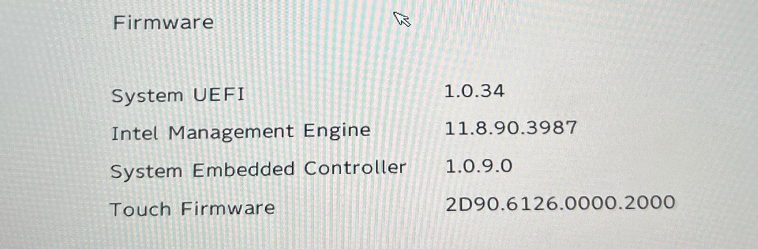

    Thanks for this Oliver. In the firmware screen we are definitely getting it without the zero, although it may be a red herring.Image
    My wife's (working) Surface Go has the exact same UEFI details (without the ".0" at the end) and hers is working.
    My daughter's Surface Go is not. I have no clue what the difference between the two is!
