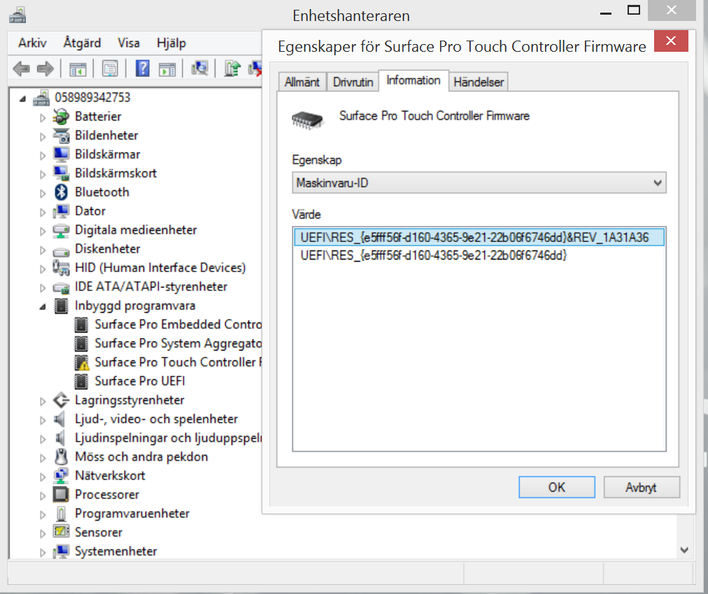

    After spending some 12 hours troubleshooting this (I had tried everything described here and dozens of other threads) it came to my mind that it had to be different hardware versions of the controller "device". It's not uncommon for OEMs to do minor revisions or upgrades of internal hardware without actually releasing them as a new/upgraded product.
    Below is a screenshot of a Surface Pro 3 fully updated as of 2014-11-13 19:00, albeit failed Surface Pro Touch Controller Firmware. The Machine Device-ID ends with 1A31A36 (the text before refers to the actual controller device). And yes it's a swedish system.

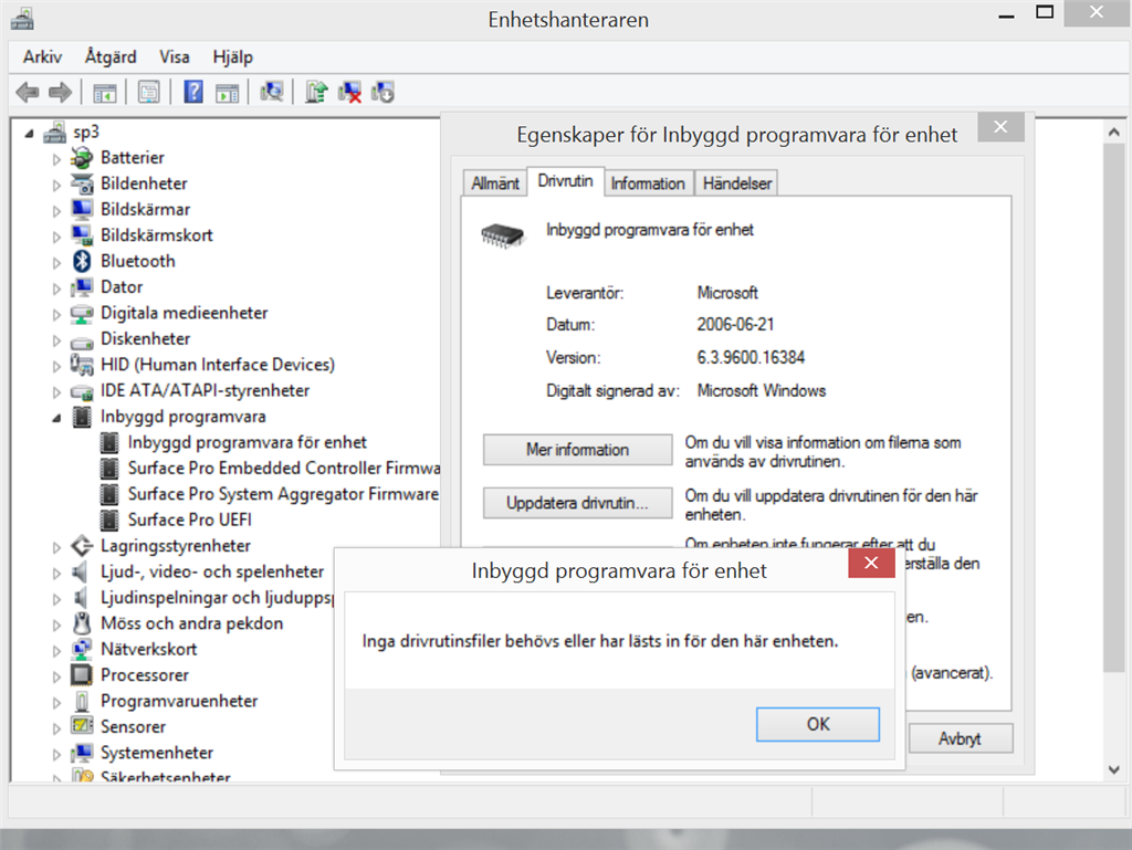

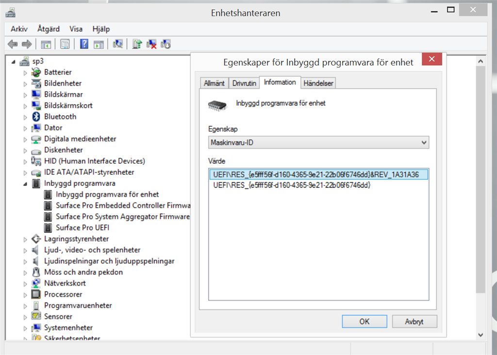

    Below is a screenshot of a different Surface Pro 3 with the same problem, only just moments ago Reset:
    It currently has no active driver: "No drivers was needed or have been initiated for this device"
    Reason being of course that the Surface Pro 3 was released before the docking station was available, but the firmware was there anyways.
    Our problem is that the touch freaks-out and Right mouse clicks (not touch, there's a difference) when the device is attached to the docking station. If we unplug it, the touch experience is as normal again.
    A different Surface Pro 3 that we have has 1AA1B42as Machine Device-ID revision number. Everything works perfectly with this device.
