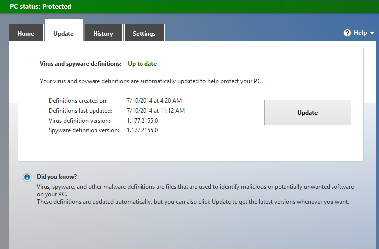

    I have Surface pro 3, running 10, have only run defender, no other anti virus. how do i automate defender signature files?  [SOURCE]
    ...the pc was upgraded (about 2 months ago) from windows [8.1]...
    Assuming Win10 64-bit...
    We'll need to "dig a little deeper" here. Please answer each of the following[admittedly tedious] diagnostic questions in a correspondingly-numbered list in your very next reply, preferably without quoting this post:

    2a. What Definitions version is currently displayed in Defender's Update tab?
