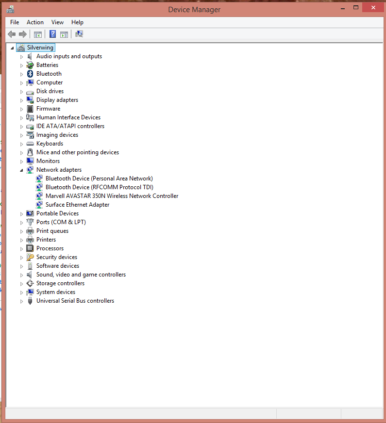

    It is tough to say when it started. I first noticed it when I bought the dock. Of course, this is also when I started using my Surface Pro 2 as my primary machine. The issue occurred again this morning. Looking at device manager, everything looks fine (see below image.) As for toggling Airplane Mode, that also has no impact. It was a little tricky to do since when I click the network bars in the system tray to access Airplane Mode, nothing appears. I had to use the search feature to get to airplane mode.
    Thanks for the help, let me know if there is any more information that would help diagnose this issue.
