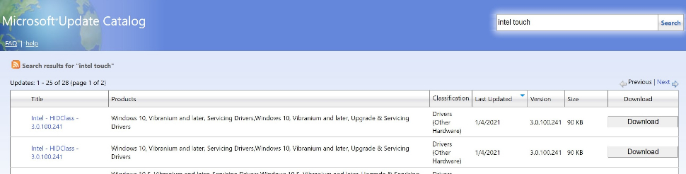

    • device manager ... deinstall device (inclusive "Deinstall drivers"): Intel Precise Touch not there (of course)
    • installing the driver as mentioned in my first post - still not there
    • looking for new devices in device manager: it appears again (with driver 2.1.0.59)
    I've also tried your tutorial (as there is of course no corresponding KBnumer i tried a fantasy number and the original .cab-name), but failed to open package...
    2021-04-30T11:12:01+00:00
    Odd, can you remove the driver completely and then add manually? Just wondering if rather than update it, remove and the install?
    There is a process here How to Install cumulative updates CAB/.msu Files on Windows 10 (thewincentral.com) worth a go, but i can't vouch for the site!
    2021-04-30T10:25:50+00:00
    I also have the compatibility issue with Surface Pro 7 and Slim Pen and device manager says "Intel 2...." instead of "Intel 3.0.100.241". So I downloaded it from the mentioned update catalog, double clicked on the .cab-file and unzipped all of the files inside, right-click on the .inf-file ("successfully installed"), but still the 2....-version. Tried the same by unzipping to system32/drivers - still the same. Of course I also tried to manually install from device manager / update driver / search my computer / select folder and so on.
    I'm too silly to install that driver?
    2021-04-29T08:29:30+00:00
    I don't know anything about the site, but it shows a download option  - worth a shot? Edit - it's the MS site lol.
