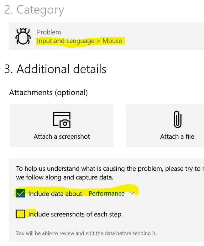

    I've been watching this thread for a while and asked an internal contact to look into it. He has responded as follows:
    I was able to reproduce this issue although not as easily as some say.  I have been running tracing and working with Windows engineering.  The best thing I can recommend that is customers report this issue via feedback hub.  Choose the input and language\mouse and include data about “Performance”.  Uncheck the screenshots of each step.
    I would urge everyone to use the Feedback Hub and file this report and share the feedback and post a link here.
