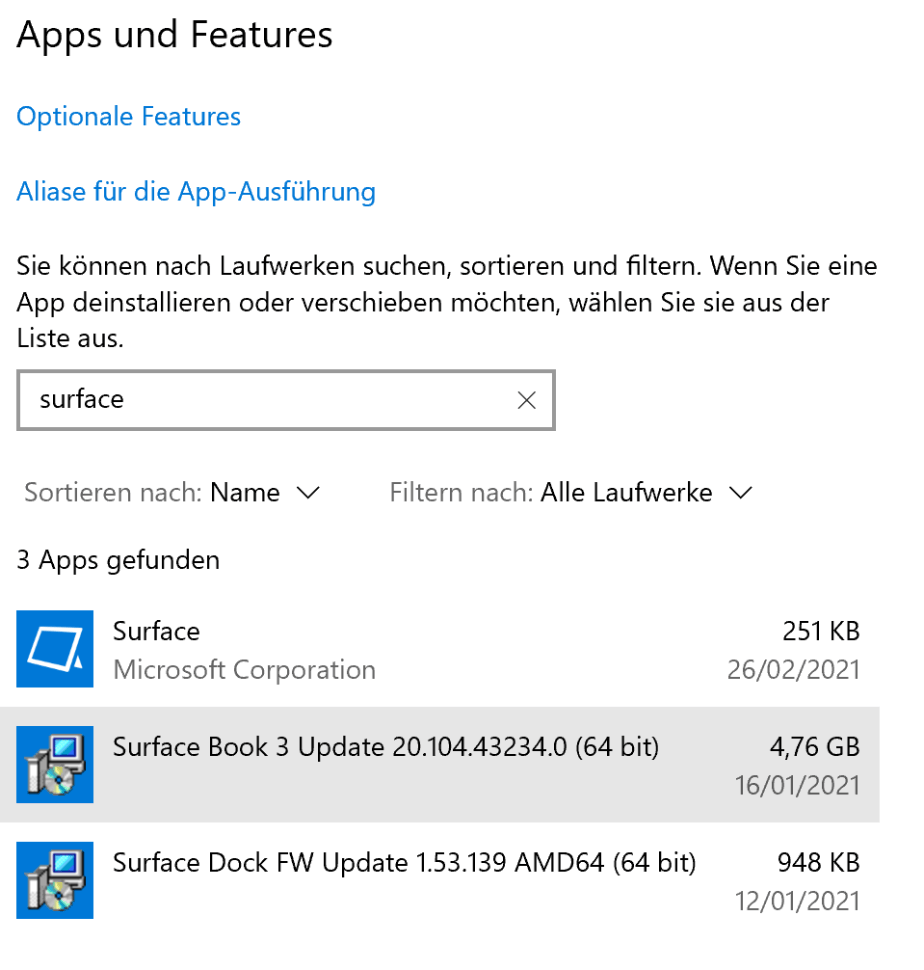

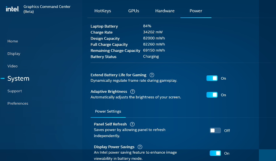

    I had the mouse freezes on on my new surface book 3 15'' Model.
    I tried all Updates, manual Firmware-Upgrade, checked USB-Settings. This fixed this issue in January. In February I had the Problem one time, detaching and reattaching the display helped.
    But the freezes came back today. I'll try the "disable Panel Self Refresh fix". If this doesn't work, I'll try the usb-inference Theory by plug in the mouse-Dongle with a short cable.
    In the beta version from the ms-store the Option is there:
    Hope this helps. Hope this solves.

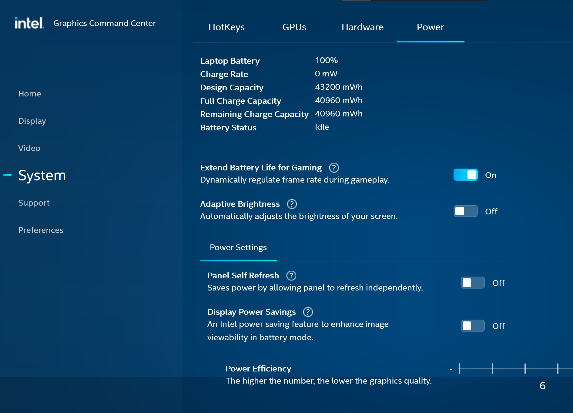

    2021-02-25T22:54:39+00:00
    I just installed the latest intel graphics control panel on my surface pro 7 and the options are here. See attached.
