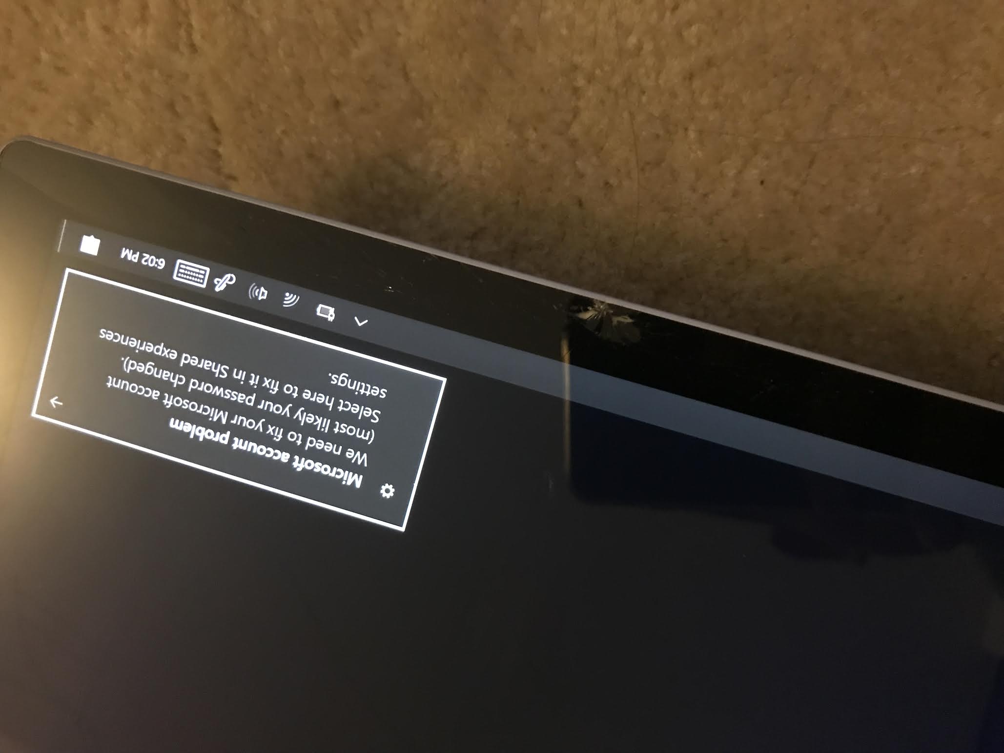

    Hi Bryan, I have this exact same issue with my surface pro 4. I contacted Microsoft and was told to send the device to microsoft for a replacement (case # 1488479428). A few days later I received an email with the message below.
    "our device or accessory was not serviced. During our inspection, we found damage that your Limited Warranty does not cover."
    the device was returned to to me unrepaired, unreplaced. to make matter worse, my laptop came back with a huge HOLE at the bottom. Not only did microsft not fix my device under the warranty, you guys actually made it worse. i'm very upset and very disappointed. what can i do to about this situation? please help.
