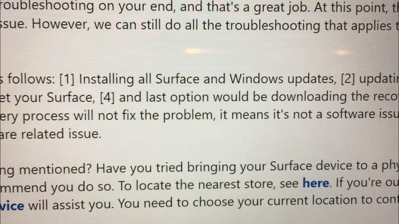

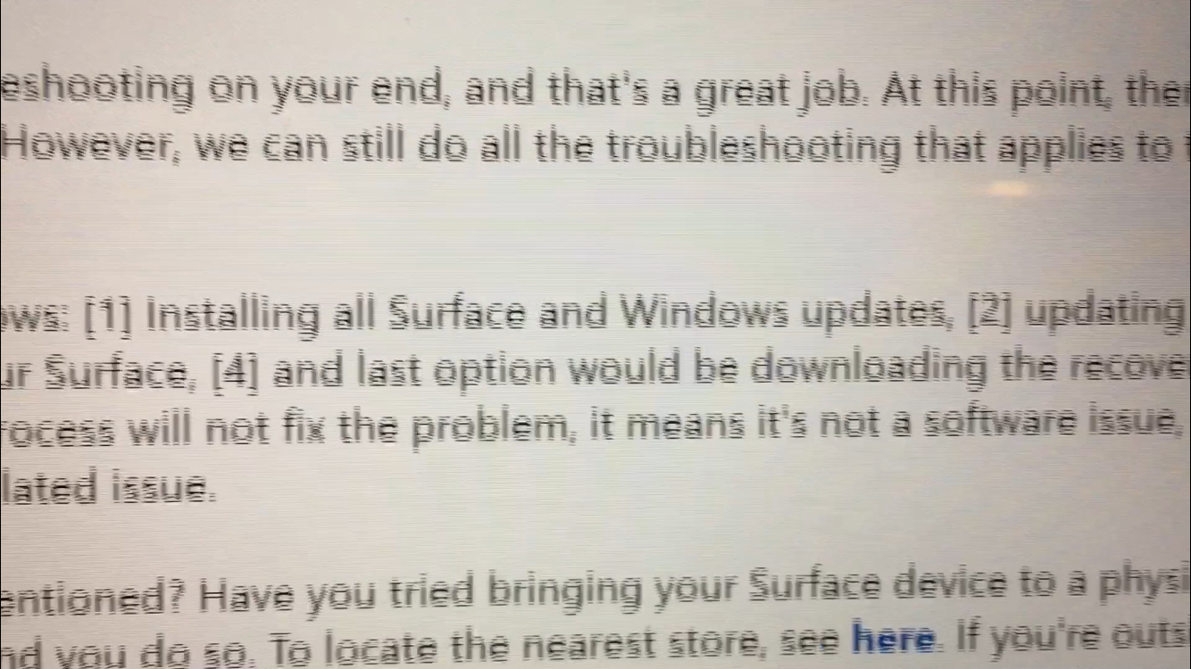

    2018-02-24T10:27:24+00:00
    I live in Thailand. I bought my Surface Pro 4 in January 2017. After using it for 6 months, my machine started to randomly develop the screen shaking/flicking problem. I've been trying to fix this problem by myself as many recommended solutions I could find in the internet, but nothing permanently help get rid of my issue. The screen shaking/flickering still randomly occurs these days. Very disappointed with this product being claimed as a premium machine. Now I've decided to switch back to Apple MacBook Pro (more reliable and very good build of quality). I will never recommend any hardware products from Microsoft to my customers.
    My Surface Pro 4 is going to end of warranty in March 2018. Going to call Microsoft Supports in Thailand if they have any offers.
    (Above is a sample captured shaking screen on my Surface Pro 4)
    ![](https://learn-attachment.microsoft.com/api/attachments/f04c7472-5769-4b3b-8f34-25cfccde99bc?platform=QnA
    (After any movements like moving mouse cursor, the shaking screen disappeared. Yes, you have to do this every time)
