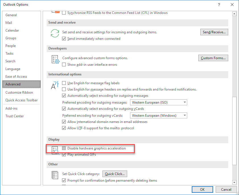

    I've not seen the issue for 3 weeks now. Not sure exactly which of the following (or combination) has solved it but here's what I have done so far:
    - run sfc /scannow (as administrator) .
    • Installed intel command centre as disabled panel refresh (on battery and plugged in)
    • disabled hardware acceleration on all office apps (including teams and outlook) and browsers (edge and chrome)
    • updated the latest intel drivers (Version: 27.20.100.8187 released 5th may)
    2020-04-23T13:49:45+00:00
    Another insight, someone suggested to "disable hardware graphics acceleration" in Outlook settings (which likely disables it for all of Office) as a temporary workaround. I'll give this a go and see if it behaves better and report back. Makes me believe this could be a display driver/firmware issue now if it works.
