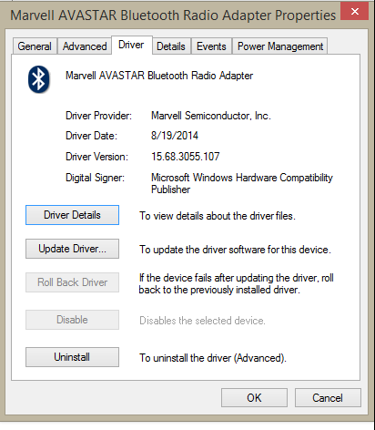

    I don't see a rollback option.  I've tried the basic troubleshooting sets.

    That's strange. I see the roll back option on my SP3. Did you install any software from Logitech for that keyboard?
    Microsoft removed older versions of the BT driver from the Surface driver download page, unfortunately. I'm wondering if you could do a system restore to a point before you applied the September patches and see if the issue is fixed. (Those updates will install again unless you change your Windows Update settings).
