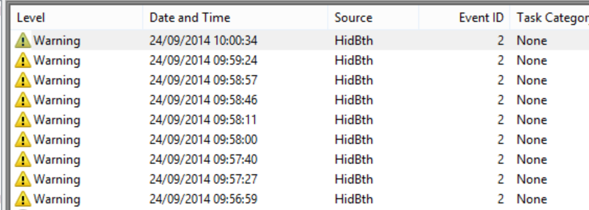

Looking into the event log for Administrative events, I see this:
Bluetooth HID device  either went out of range or became unresponsive.
I also see another event within seconds that says this:
Metadata staging failed, result={66F5F5A4-2104-53C0-BCDF-9DD1AF9AE33F} for container '0x80070490'

    2014-09-24T09:05:43+00:00
    My Bluetooth mouse and headset are completely unusable this morning. Both disconnecting every 30 seconds now :(
