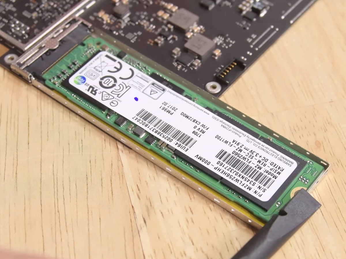

    Microsoft support will not help you, they are clueless.
    The SSD used in the Surface Book 2 is PM961 (MZVLW256HEHP), Samsung is the manufacturer but they are notresponsible for this issue, it's an OEM drive - Microsoft is fully responsible for its implementation and performance. This is why Samsung don't provide any support, they only do this for SSDs they sell to consumers.
    The specifications for that drive is here: https://www.samsung.com/semiconductor/ssd/client-ssd/MZVLW256HEHP/
    It has been manufactured with a capability of 2800 MB/s Seq. read and 1100 MB/s seq. write. Microsoft has implemented it in such a  way as to get far worse seq. write than the drive is capable of. This could happen in one of four ways:
    1. Microsoft wrote the driver, either badly or with a bug.
    2. Microsoft made the circuit board and controller on the Surface Book 2, which was poorly done or done outside of recommended specifications (hampering performance).
    3. They asked Samsung to make a cheaper and slower version, and purchased that.
    4. Microsoft deliberately throttles performance in order to save on battery and reduce heat.
    So which is it, Microsoft?

    I too have spoken with Microsoft Support as I have recently purchased a Surface Book 2 15 Inch 256GB and have also noticed slow SSD speeds.
    My Microsoft representative I spoke with (Emily) also spoke with a Samsung representative and apparently the Samsung rep couldn't even find the model SSD that is in the Surface Book 2. I will be hearing back tomorrow and will keep this post updated.
    Even in Samsung Magician, it says that it is not supported and when you look at the details of the drive, even the manufacturer is UNKNOWN, even though it has SAMSUNG in the name lol.
    After some research of my own, I found a reddit post: https://www.reddit.com/r/Surface/comments/7bfgf7/ymmv\_surface\_book\_2\_demo\_units\_are\_now\_at\_best\_buy/dpk9wra
    He says the drive is a PM-951 and after finding you can buy one on Amazon ( https://www.amazon.com/Samsung-PM951-256GB-Solid-MZVLV256HCHP-00000/dp/B01DTXUT0K ), it says the specs are 'up to 1000 MB/s reads and up to 280 MB/s writes'.
    These specs still don't add up to what I am getting (2500 - 3100 MB/s reads and 330 MB/s writes), so its weird.
    Its like the Reads are operating at what you would expect from a x4 NVMe drive, but the Writes are operating at what you would expect from a poor SATA SSD.
    I also tried the SAMSUNG NVM Express Driver 3.0 and no change.
    All the latest Windows updates are installed.
