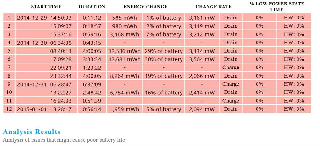

    2015-01-01T11:32:02+00:00
    Screenshot attached. Notice the battery drain of up to 3500mW!

    Guys
    I'm wondering if we're going down the wrong path with this USB xHCI thing. The USB controller is presumably a low power device that is meant to remain on. In the absence of a true "battery drainer" this will of course promote what's left to the top of the offenders list! Remember the tool is ranking them by time activated, not actual battery drain.
    Instead, what I think the issue is (at least for me) is the device simply never enters low power state. I don't have AnyConnect or Skype installed at all. I tried to attach a screenshot and ran into issues, so I'll try that in a separate post.
    I was hoping some others here could mention what their % Low Power State Time is, and where the USB controller sits on their offenders list, if at all. Both viewpoints (with and without battery issue) are helpful, but please state which camp you're in :)
    Thanks
