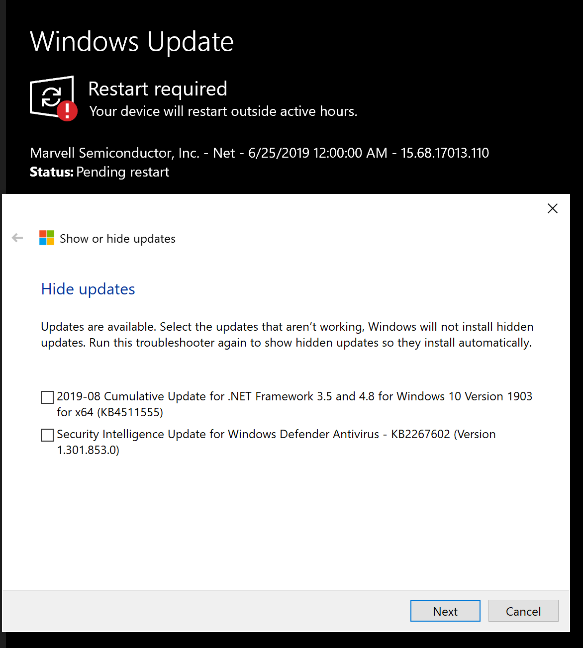

The title says it all, I updated the wifi driver to "Marvell Semiconductor, Inc. – Net – 15.68.17013.110", and after that update, I can't connect to a 5GHz wifi connection, I can only connect to 2.4 GHz. when i try to connect to the 5GHz, it says: "Unable to connect to this network". Uninstalling the wifi driver, and restarting the device did help me get the 5GHz connection back to my Surface book, but when i decided to try to install the same driver again, and try to connect to 5GHz again, the same "Unable to connect to this network" appears. Does anyone have this issue?

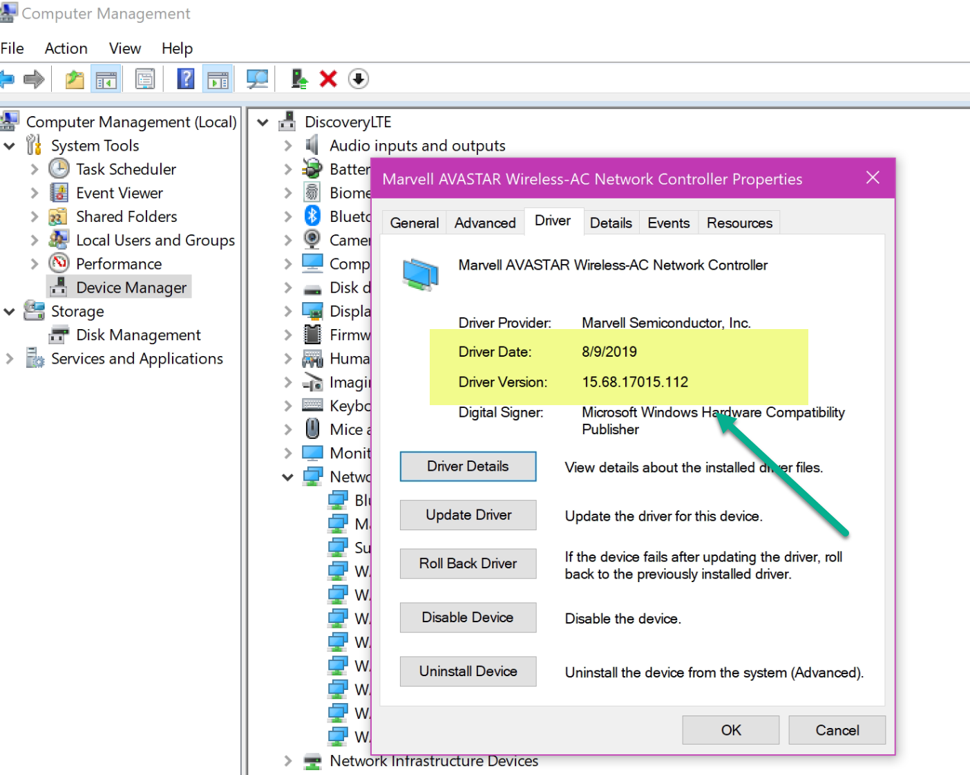

    if you have this issue with the .112 driver, it is critical that you use the Feedback Hub app to file a problem report and include all the details of the Tenda firmware and model number. They know about the issue with .110 and the .112 released to Insiders is supposed to fix issues.
    Can you triple check that device manager shows the .112 driver? Once you verify this and file the Feedback Hub report, please get a shared link from your problem report and reply with it here. I will attempt to escalate this after I have your link to your report.

    To be clear, you installed the beta driver 15.68.17015.112 because you could not connect to Tenda's mesh network at 5GHz with the previous .110 driver and still have this issue?
