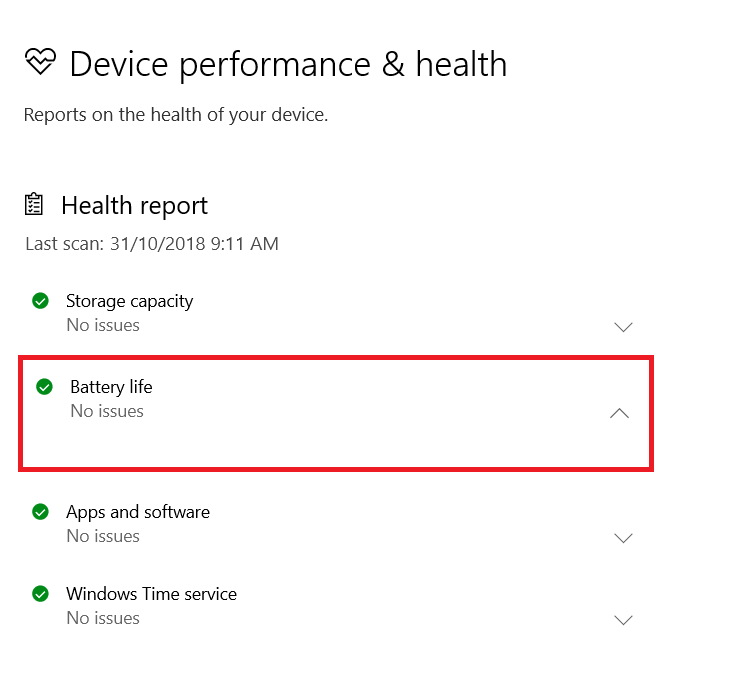

    Based on what the Windows 10 diagnostic tell me, my battery is in good shape but why it still can drain after shutdown?

    If the number is incorrect in your battery report, might that effect other battery type operations.  A capacity of only 38 mWh would only last a couple of minutes.

    My old surface has shown 38mWh as designed capacity as well. But its normal that the capacity varies between different batterys.
