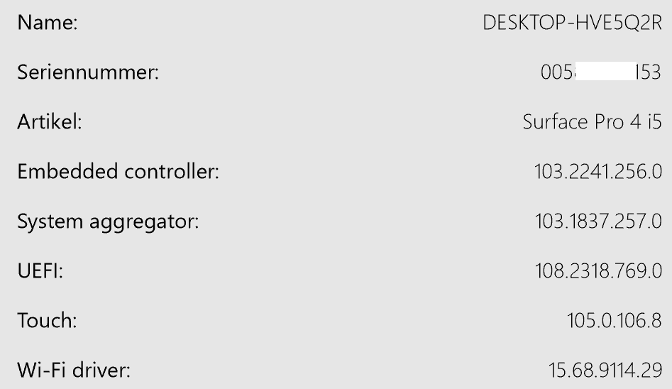

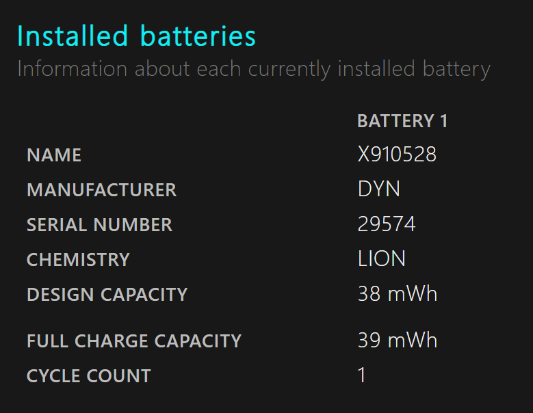

    2018-10-27T21:49:25+00:00
    So far it seems that my issue is solved with the new replacement unit. Now after 24h with all updates + newest firmware installed i didnt lost 1% of my battery charge while the surface was shutdown normally. I will verify it over the next week whether the problem is 100% solved or not.
    Also which battery model do you guys have installed? Unfortunately i didnt save my old battery reports to compare it with this replacement device, but i think the device i had the problems with had the battery manufactured by smp. Dont get confused by the better count, this device is cleary not brand new, since  the installed SSD has 1383 hours of usage. The cycle count probably got reset somehow
