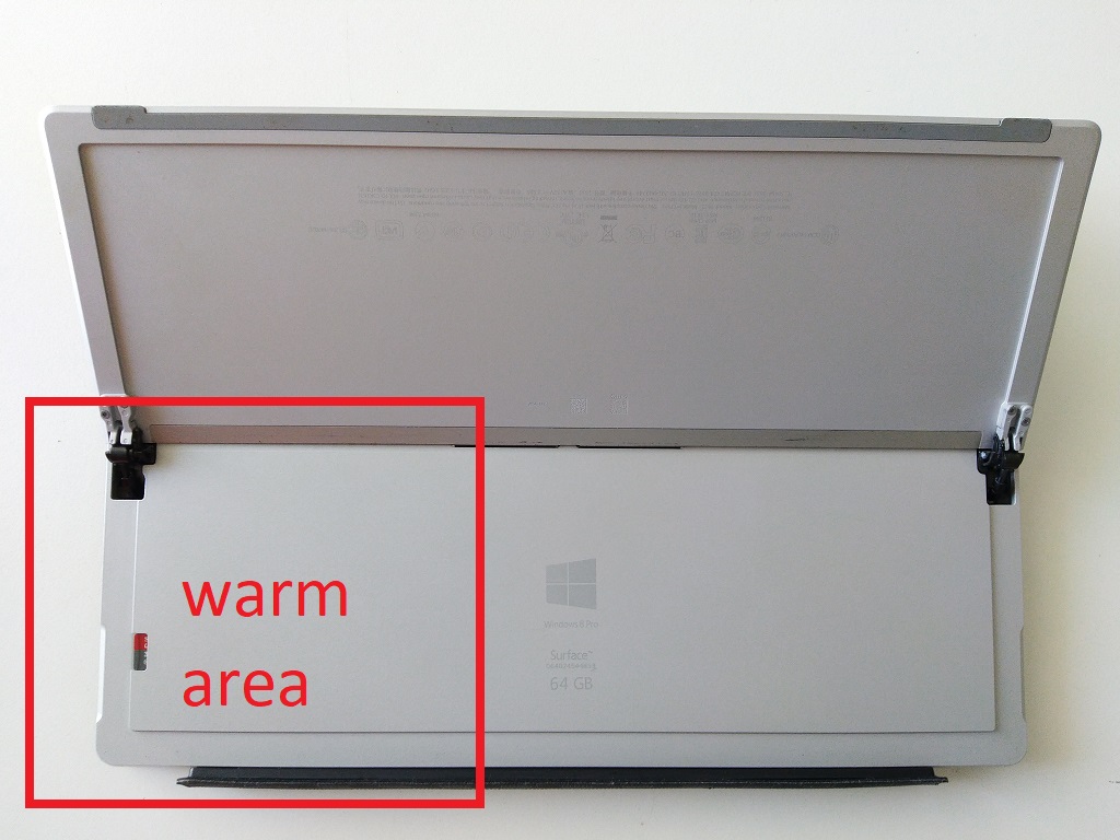

    2018-09-19T08:14:55+00:00
    For my device, I always feel like the SSD area is warm even after shut down for a long period.
    Could be the device not really shut down and some process is still running due to "Modern Standby" feature that Microsoft proud of?
