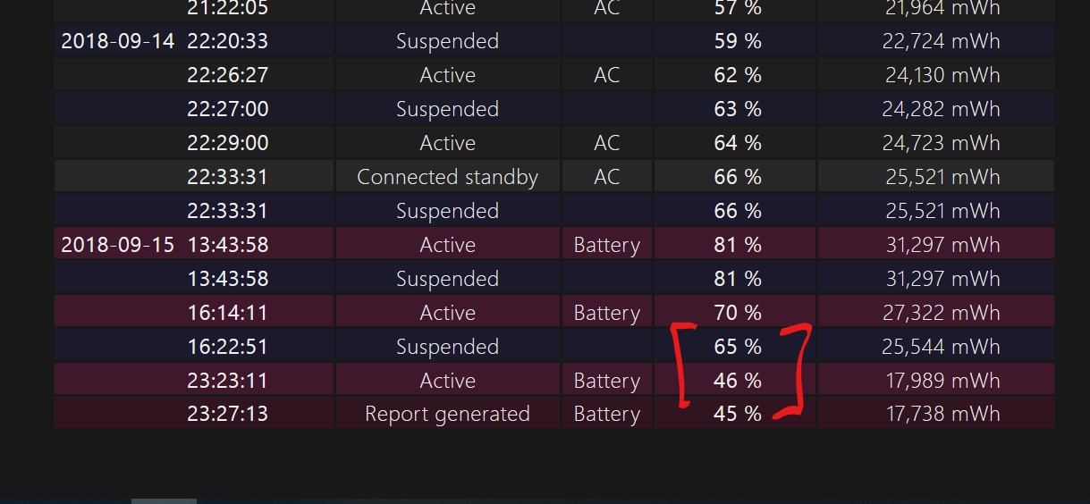

    2018-09-17T22:30:12+00:00
    I had the thing charged up overnight and this morning at 8am pulled the plug and turned it off - shutdown, not sleep or hibernate. It's just gone 4pm now and after 6 hours of being shut down the battery is at 75%. That's 25% gone in 6 hours.
    An update on my battery test. I just noticed an error in the times, 8am to 4pm is 8 hours, not 6 for 24% drain.
    It's now 8am on the day after I left the message above. The Surface was completely out of battery this morning after 24 hours in shut down mode, Brydge keyboard turned off, and no power cord attached.
    I'm planning on charging it again today and start another 24 hour discharge test, but this time start at 8pm so I can check it hourly after about 20 hours.
