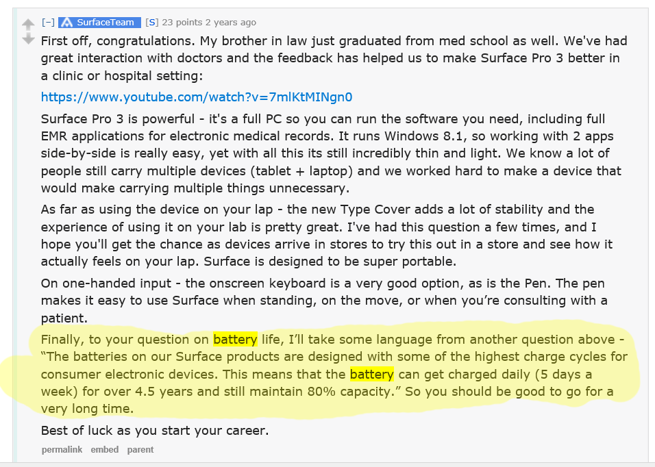

    https://www.reddit.com/r/IAmA/comments/26m9cu/we_are_panos_panay_and_the_surface_team_at
    "The batteries on our Surface products are designed with some of the highest charge cycles for
    consumer electronic devices. This means that the battery can get charged daily (5 days a
    week) for over 4.5 years and still maintain 80% capacity." So you should be good to go for a
    very long time. "

    Need you to start a new thread "LGC, battery life not as stated expected and not as stated on Reddit".
    Repost your battery report there and you can copy the above screen shot and text that I added as well.
