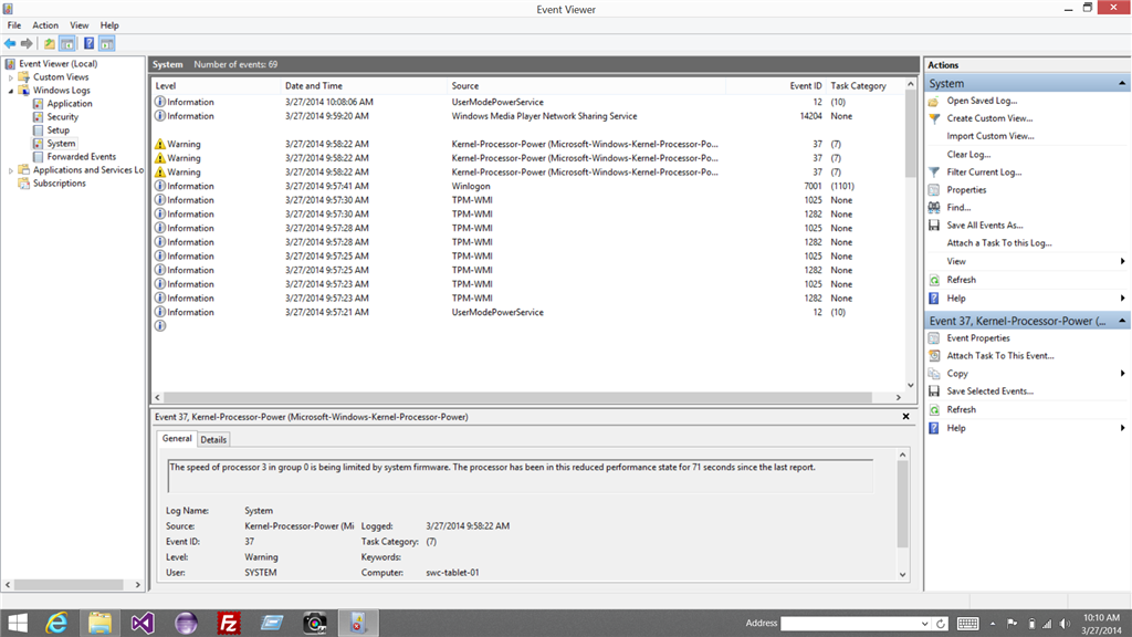

I have a new Surface Pro 256 and I keep noticing these warnings (Event ID 37) in my System Event Log and wonder if anyone else is getting these.  There are 4 warnings in a row as follows (see attached screenshot):
The speed of processor 2 in group 0 is being limited by system firmware. The processor has been in this reduced performance state for 71 seconds since the last report.
The speed of processor 0 in group 0 is being limited by system firmware. The processor has been in this reduced performance state for 71 seconds since the last report.
The speed of processor 3 in group 0 is being limited by system firmware. The processor has been in this reduced performance state for 71 seconds since the last report.
The speed of processor 1 in group 0 is being limited by system firmware. The processor has been in this reduced performance state for 71 seconds since the last report.

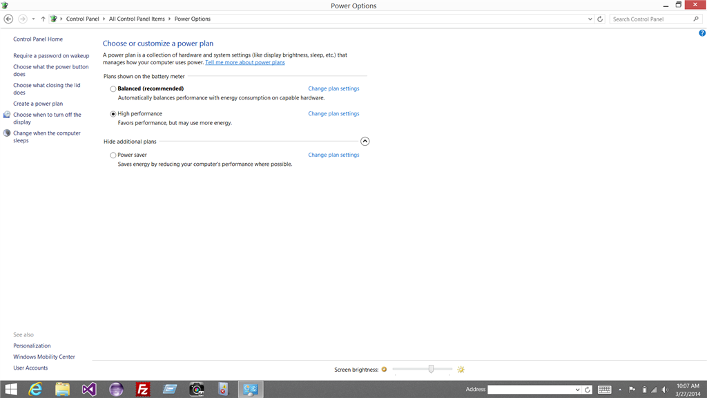

Did you change the advanced options in the power plan such as the PCI express and processor power management?  I know the default for the cooling policy is passive which will slow the processor before increasing fan speed.  Active will do the opposite increase fan speed before slowing the processor.  Also the minimum processor state will need to be changed it allows allow the CPU to automatically down clock.  Default is 5% increase it to 100%.  Also change the graphics to max performance since it is built into the CPU.  Changing all of this will really cut the life of your battery an heat things up.
