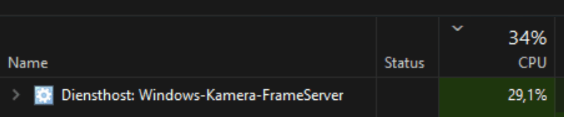

edit: still not fixed. except now it's even causing high cpu load without anything using the camera after a crash:
