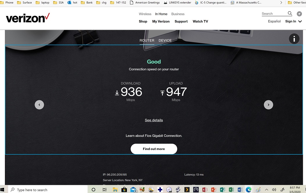

    I want to let everyone know my latest testing and it is GREAT news!!
    This testing was all conducted on wireless 802.11 AC  (i don't have AX wifi 6 yet) using my surface pro 7 I7 with 16 gig memory (which should not matter with testing wifi)

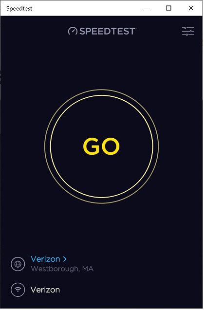

    1. DO NOT USE SPEED TEST app by ookla from MICROSOFT STORE!!!    The ookla web page test was a little better but i think ookla has problems.   Totally bogus readings!!!!!  OOKLA last year speed testing was AWESOME but they did something that has screwed up their service last year and OOKLA has not been the same since and I am now dropping ookla from my life them like a lead balloon.
    2. NOW to the good stuff. My router internet is gig speed as indicated here 936 down 947 up

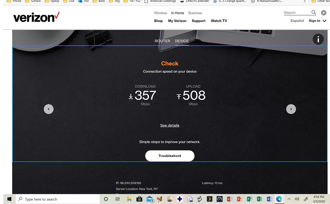

    3. my DEVICE(surface pro 7) speed from Verizon web based app for my device is awesome 357 down 508 up

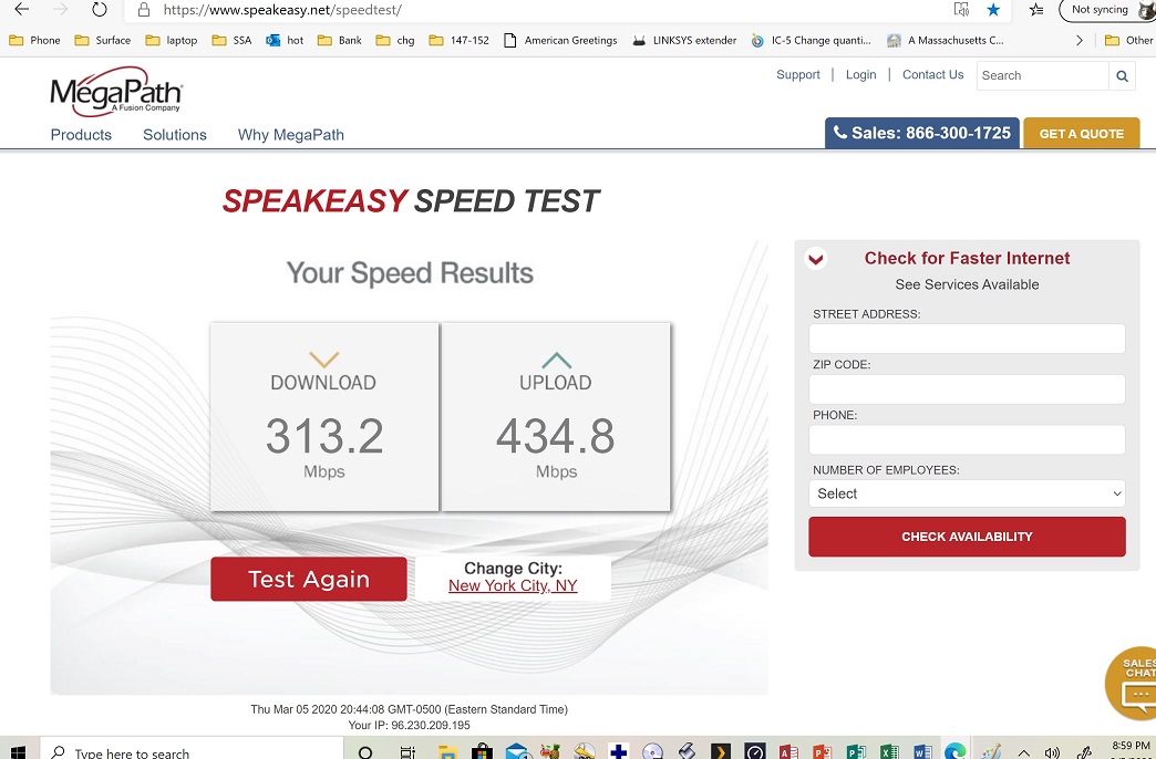

    4. this is also verified with SPEAKEASY.NET (i used to use this web page a lot but stopped... I am bringing it back into use from now on.  313 down 434 up

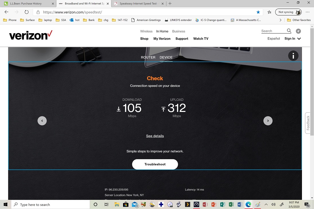

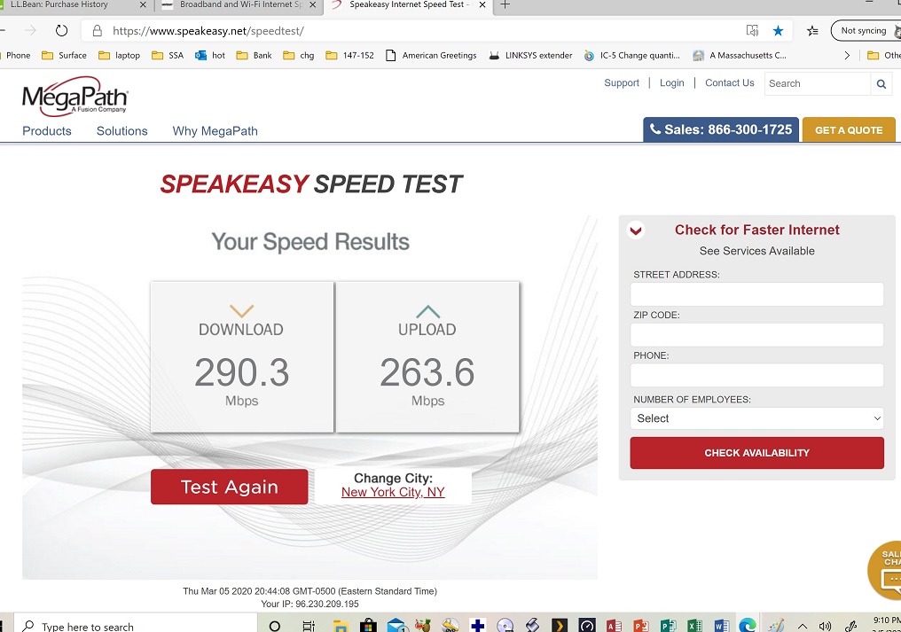

    5. so I placed the surface pro to sleep to test again when it awakes.  There is still a problem with Surface pro 7 waking up with speed testiung BUT not like what I though with the bogus OOKLA STORE APP  Verizon web based speeds 105 down and 312 up and from SPEAKEASY.NET web base speed check and 290 down 263 up
    IN conclusion, There is a problem with the speeds when the surface pro 7 wakes up but nothing like the bogus OOKLA app was giving me and I was led to believe.

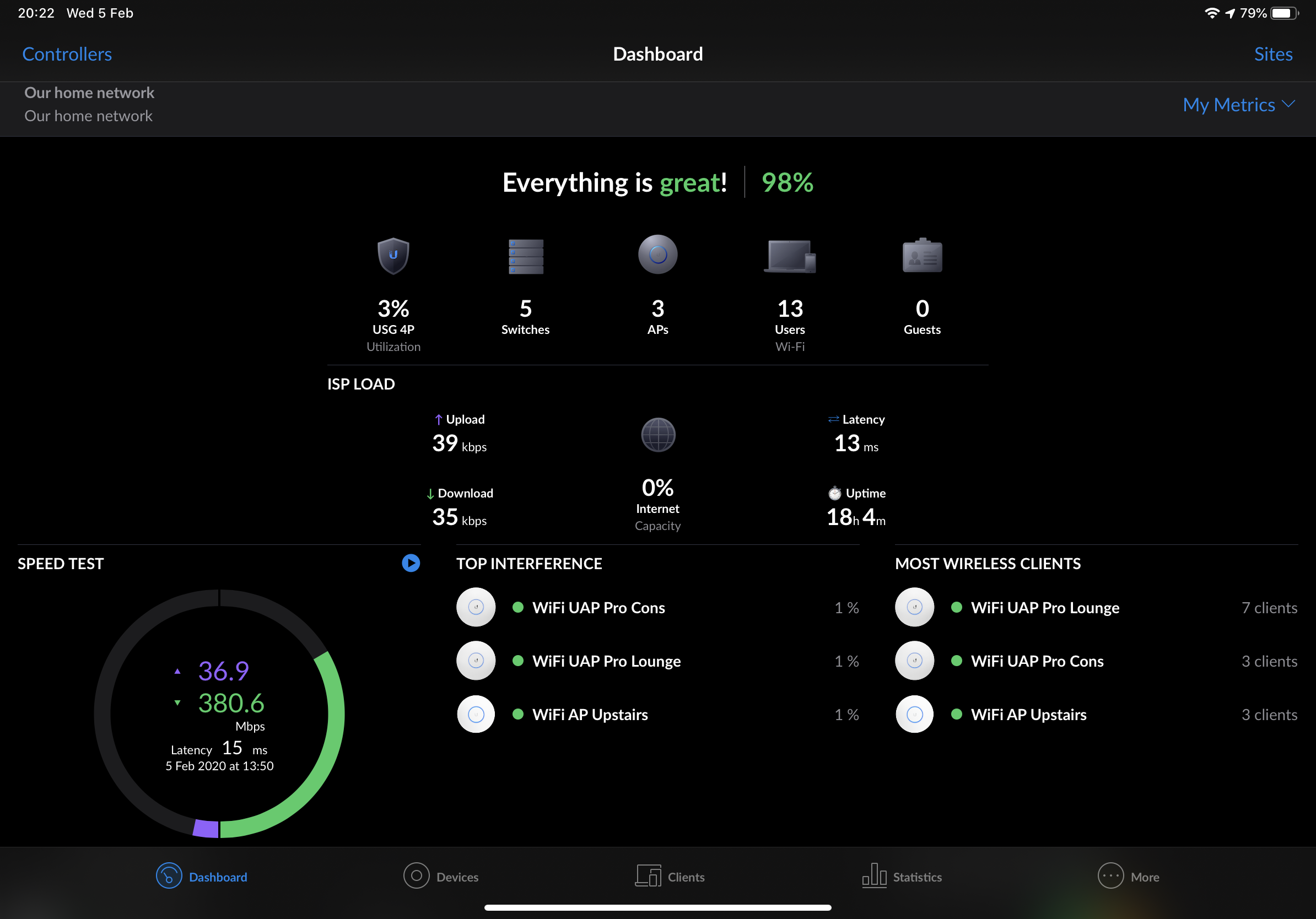

    I too have an SP7 and a unifi setup (usg P, HD ap and two UAPs, cloudkey and 5 various unifi switches) with zero issues. If you have fast roaming on, switch it off, and i leave
    running controller 5.13.9 and devices on 4.2.0.1 and also have band steering off) i have no issues on a 380/3imbps cable connection. I have no issues, so I would look an unifi to make sure its good. I also have DPI and IPS on.
