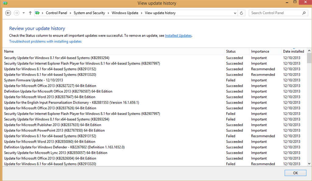

    2013-12-10T21:36:41+00:00
    Hi Steven_B,
    I have attached the screenshot plus the System Firmware Update detail that we are discussing, that failed to update.
    System Firmware Update - ‎12/‎10/‎2013
    Installation date: ‎12/‎10/‎2013 15:42
    Installation status: Failed
    Error details: Code 80070490
    Update type: Important
    These updates are released by PC manufacturers to help improve the stability and performance of PC hardware.
