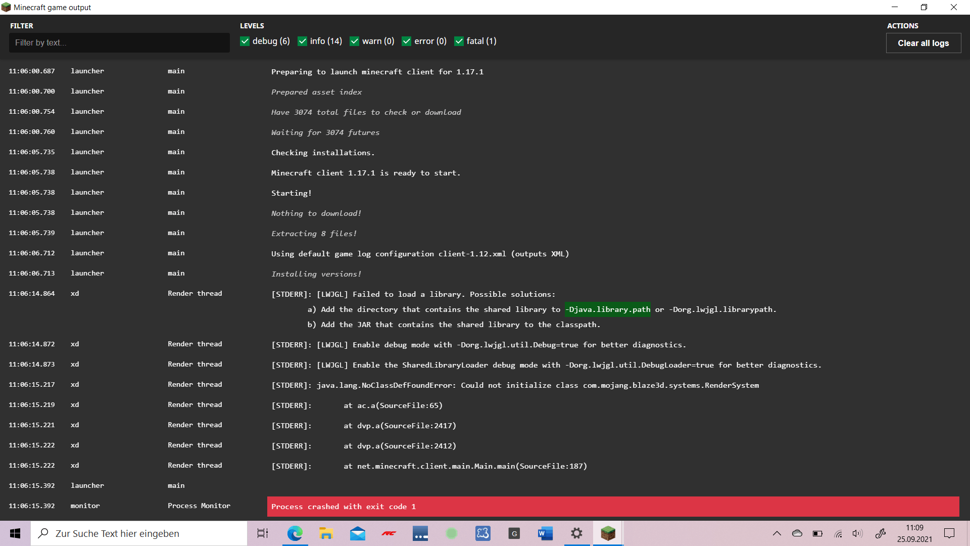

    Your 1.17.1-aarch64.json is badlyd ownloaded. It should have 69 KB, You should download only the file from Github by clicking Download button or RAW and ctrl+s, so download just this file: https://raw.githubusercontent.com/adiantek/mc-spx/main/1.17.1-aarch64/1.17.1-aarch64.json
    PS. I changed only all LWJGL libraries to snapshot version. I must change the size, hash and jar location. LWJGL started working with Microsoft from LWJGL 3.3.0 build 8 and from build 11 it works on arm64.

    Hmm, to be honest I have no idea if the language has anything to do with it.
    The only thing I can think to suggest is comparing the 1.17-aarch64.json to an unmodified 1.17.1.json file delivered by the game.
    I mentioned it before, at the time adientek posted his instructions there was only a 1.17-aarch64.json file on his github, and Minecraft 1.17.1 had just come out, so I used his file to as reference to create a 1.17.1-aarch.json file from a copy of the 1.17.1.json file myself. It's a bit tedious, but you might want to consider trying that yourself. It could be there are some differences due to language that is keeping your system from properly using the file, so starting with a json file from your system might resolve that.
    You'll definitely want to use a program that will re-format the json file into a more humanly-readable format, notepad++ has an addon that can do that I believe, or some json editor app.
    Anyway, I basically took the Mojang-delivered 1.17.1.json file, copied it into a new version folder, and using an editor, copied all the lines from the 1.17-aarch64.json file that had to do with arm64 (for the additional arm64 java game libraries) to the new 1.17.1-aarch64.json file.
    I am no expert on this, so maybe there is a much easier solution that I am unaware of. Hopefully Mojang will eventually release a native game client once some of those libraries are no longer considered "beta".

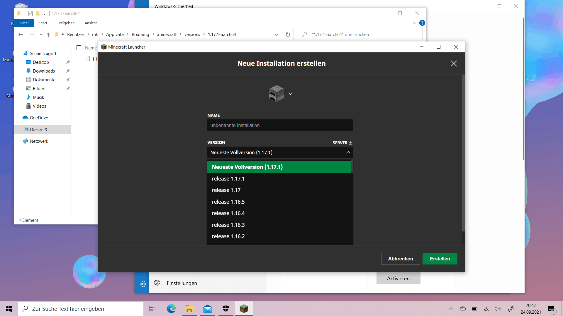

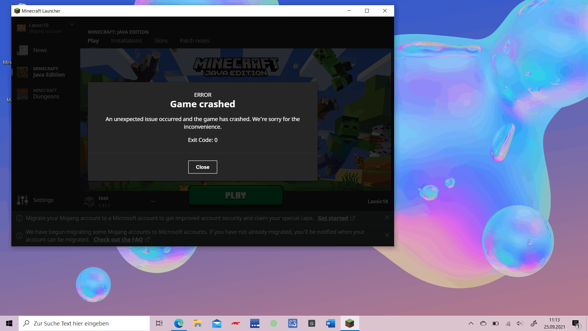

    i have no clue... Perhaps because i use german translation - but with english it is the same... I only installed those things, that adiantek refers to on github. i tried this also on the arm64 - Asus Novago from my daughter - it is the same... no aarch-64 to choose from.
    any tweak that i have to install? as i understood this json installs the right version of lwjgl, so i do not have to do something with it?
    because of the "checksums" there is no way to just copy the new lwjgl to the org-folders...
    when starting the normal 1.17.1 with the arm64-Java then there comes of course an exit....

    i thought it would work for any Windows Arm64 Device, but on my Samsung Galaxy Book S it does not work. These arm64-Versions are not listed as installable versions. I made a clean new installation of the Minecraft-launcher and deleted the .minecraft-directory first...
    Perhaps adiantek has any clue how to fix it or to run minecraft on this similar Device.
    Thanks for your help!

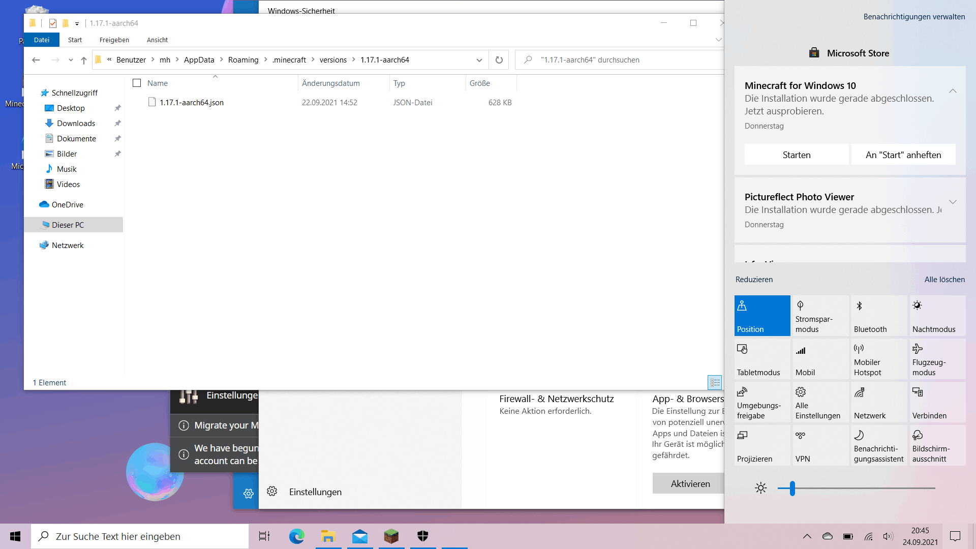

    I don't see how it would only work with a Surface Pro X, as you can create custom Minecraft versions on x86/x64 Windows too (or linux or OSX for that matter). I definitely think it should run on your Galaxy Book S, so I have to suspect something must not to setup correctly still.
    Just to confirm, you're saving the json file to this location correct?
    %appdata%.minecraft\versions\1.17-aarch64\1.17-aarch64.json
    For me this ends up being
    C:\Users\dom\AppData\Roaming.minecraft\versions\1.17-aarch64\1.17-aarch64.json
    I expect your path should be very similar, just with a different username in place of "dom".
    Once I put the 1.17-aarch64.json file in that location the next time I opened the launcher I had 1.17-aarch64 listed in the versions drop-down list when creating a new installation.
    Also, you could verify the json file did download correctly by opening it in notepad or notepad++ and making sure the contents of the file match what the json file looks like if you view it on github.
    adiantek also has a 1.17.1-aarch64.json file on the github page now so personally I'd switch to that just because it's the latest version. And I would name the folder 1.17.1-aarch64 of course.
