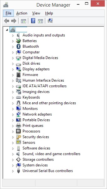

After the update, the Marvell AVASTAR Wireless Composite Device stopped working...meaning, the tablet does not recognize the wireless card.  This is confirmed by going into the Device Manager and seeing 2 unknown devices (one of them was the wireless card, the other unrecognized device I will explain in the next paragraph) When I tried running the update driver function, it tried to reinstall the driver but returned the following error.

The other "unknown device" turned out to be something called "Surface Cover Telemetry".  However, trying the same troubleshooting process for the wireless card did not solve the problem and the devices still remains "unknown" in the device manager.  I just left it and carried on with installing my other software and apps as the tablet and the Type Cover 2 seemed to be functioning properly.

    I was struggling with the same problem after October update for Surface Pro 2. Windows Update method worked fine only during first update - from that point everytime the same problem with unknown device.
    I called support hotline - no progress.
    I went to Microsoft Store - store employee spent 2 hrs - no progress here too.
    Here is workaround for this problem which works everytime for me.
    1. Restore you SP2 to factory state (you should see one device with exclamation mark - Surface Cover Telemetry).
    2. DO NOT use Windows Update to update your device yet !!!
    3.  Download drivers from here:
    http://www.microsoft.com/en-us/download/details.aspx?id=40856
    1. Deploy drivers using script from here:
    http://blogs.technet.com/b/deploymentguys/archive/2013/05/16/deploying-drivers-and-firmware-to-surface-pro.aspx
    1. Check if warning form Surface Cover Telemetry disappeared (should be gone).
    2. Reboot device.
    3. Update your SP2 using Windows Update.
    This is WORKING solution. Follow this steps and you'll get rid of this problem.
