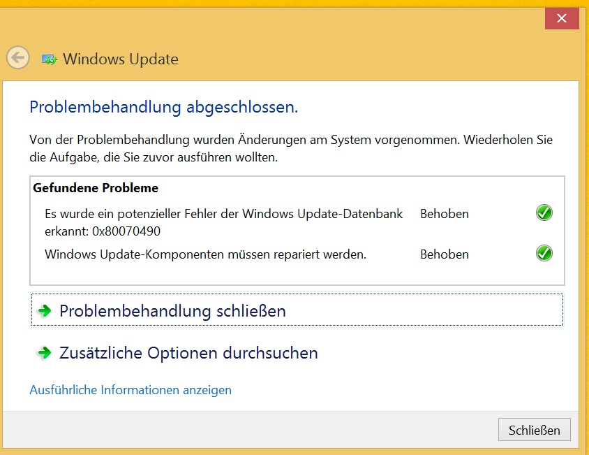

    One thing i've experienced is every time running the troubleshooting for windows update it "repairs" two problems.
