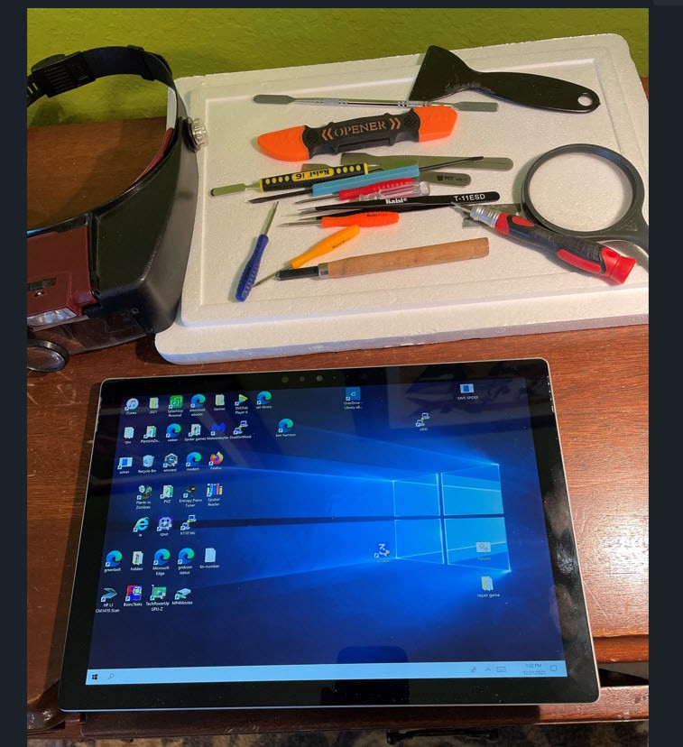

    Photograph info
    - round object with handle was magnet to find screws that fall on the carpet.
    - wood handled tool has V shape to scrounge adhesive from recessed edge area of SP4.
    Extensively used along with that blue handled scraper.

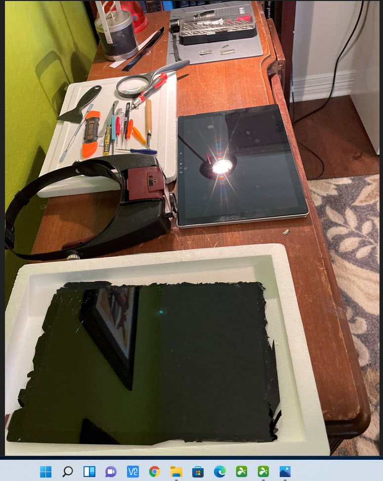

    I cannot find the url but I saw a repair where about 30-40 of those metal spatulas were placed about 1-2 mm apart all
    about the circumference of the SP4. and a heat gun was used to help insert the spatulas and eventually pry the screen up.
    I had only 2 of those spatulas and both are shown on the whiteboard.. The battery ruptured when scraping it off so do
    that outside and void breathing the gas fumes when it ruptures.
    where I found out about heating the screen using kapton tape but it was too late
