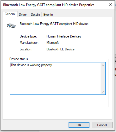

    I have the same issue, however, for me, the Bluetooth Low Energy GATT complaint HID device > Right-Click > Properties
    does NOT have a 5th Power Management Tab.
    Any suggestions?

    nope, the power management option isn't there, I checked. How do I fix this?
    Any suggestions?
    Hey, you know how your computer updates every week and shows the option “update and shut down”. Do that and it should work. Worked after I updated mine.
