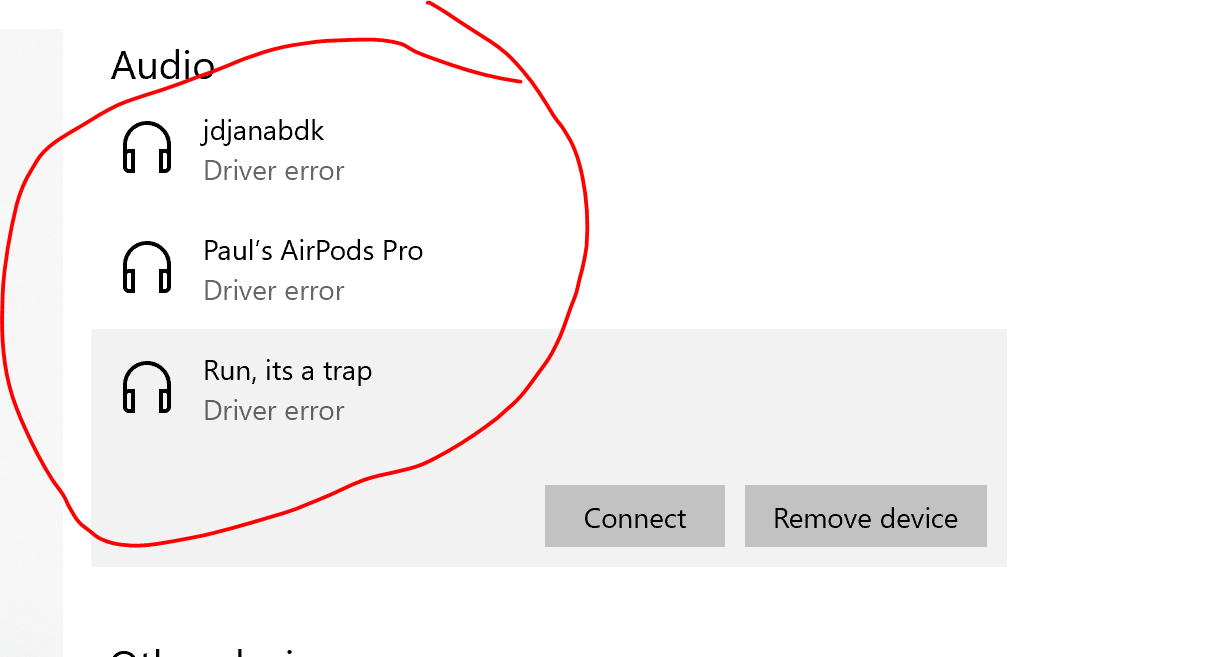

    2020-06-04T04:01:47+00:00
    Hello again,
    This problem persists and so I resorted in spending even more money and getting another bluetooth speaker that is not apple. I am having the same problem where it says it is connected and yet it is not.

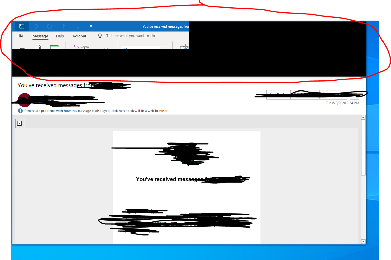

    Additionally, a new problem has begun to happen, remember when I said that a new something would go wrong?, well yes it did. Now, when I open Outlook (their own in house application) the windows show up with half the pop up in black and unreadable. see below.
