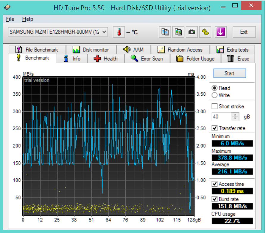

    2014-11-11T22:25:19+00:00
    SP3 128GB. Owned for almost two months.
    Thanks!  But for anyone else please note that it is just the performance graph as your system currently is that is what we need to see.
    Doing an optimize or TRIM on it's own won't help since your system does that while in use anyway, every week and for every file you delete.  Also there is no need to run DiskFresh, unless you really want to.  The performance graphs before running that already seem to be clearly showing the problem I originally posted about is present and that is what we could do with more examples of.

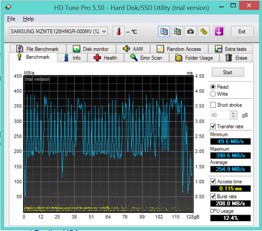

    2014-11-11T04:58:34+00:00
    Prior to manual TRIM
     Post manual TRIM
    2014-11-09T15:14:11+00:00
