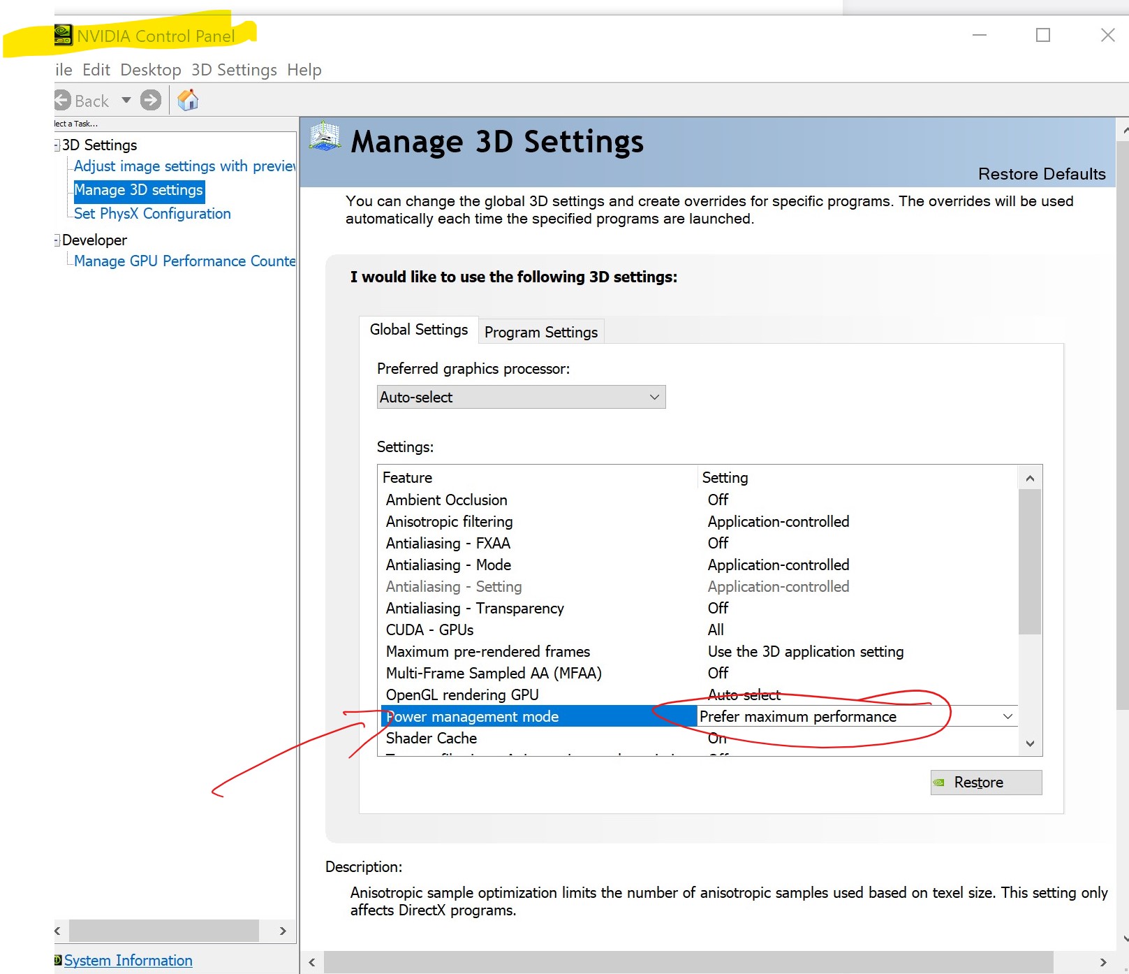

    i have modified the settings in nvidia panel and till now the problem has gone. being usign sketchup for 1 hour without no problem.
