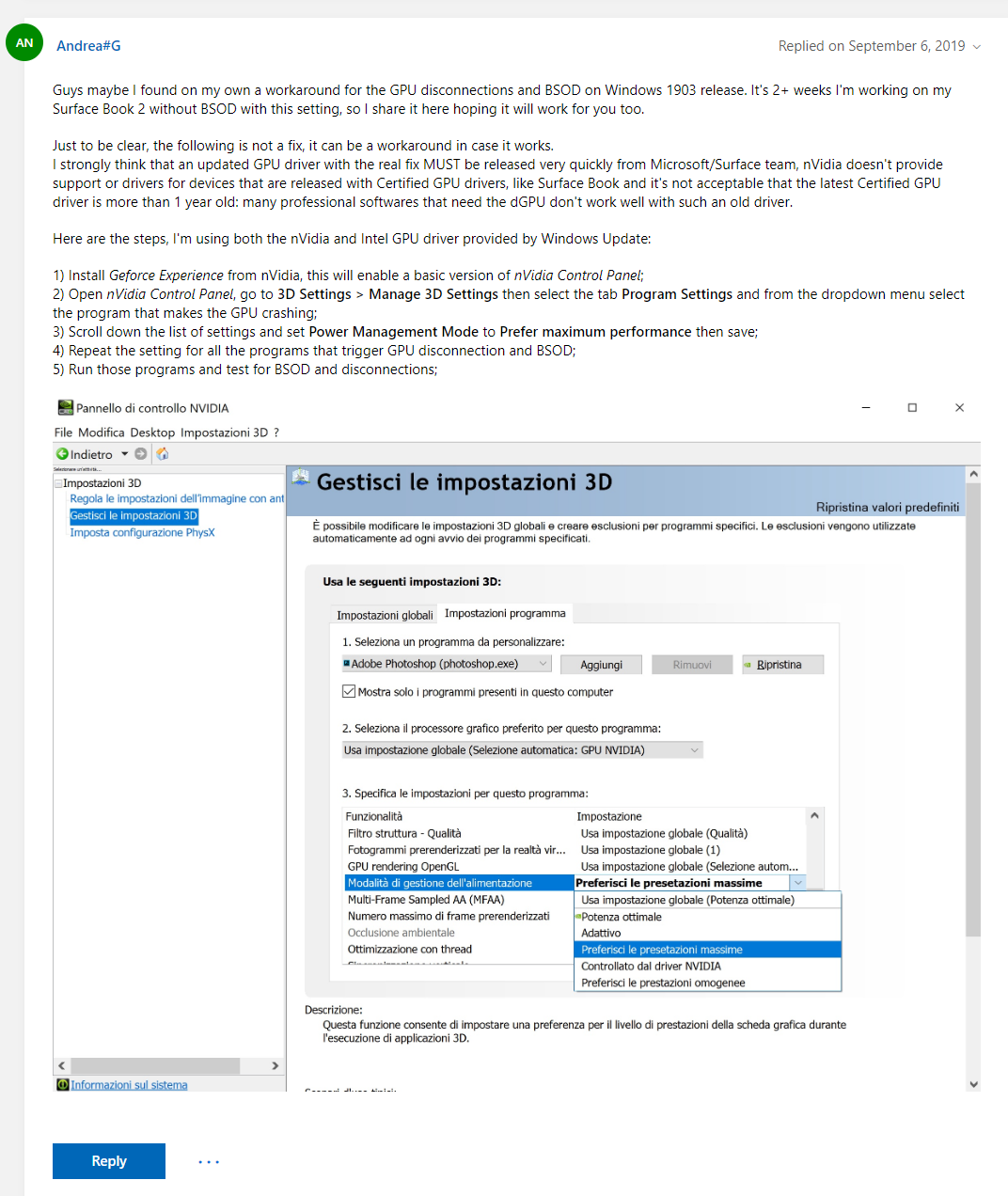

    I'm not excusing Microsoft's handling of this, but in case it helps anyone else on this thread, I just wanted to reiterate this workaround; it has solved the issue as described in the original post (i.e. the GPU disconnecting) for me and for others in this thread.
    Note that others have complained about BSODs related to the GPU; I can't speak to that as I've never had that issue. I can only say that the following workaround SPECIFICALLY works for the GPU disconnecting.
    https://answers.microsoft.com/en-us/surface/forum/surfbook2-surfdrivers/surface-book-2-gpu-driver-disappears-randomly/57233544-e262-45bb-a6a6-0d04197b7498?messageId=e7806b8d-999d-4320-b8b7-a07952e6de37
