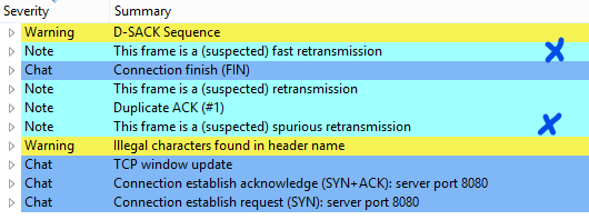

    I think that I understand at an abstract level what is going wrong. In the trace there are 127 retransmissions: 94 fast retransmits and 33 normal retransmits. Each retransmission causes the "congestion window" to close a little (and, therefore, the throughput to be reduced). Most of the "fast retransmissions" are "spurious" (were not actually needed). WireShark "Expert Information" shows:
    Both "fast retransmission" and "spurious retransmission" are mentioned. Here is a more detailed view of what is happening:

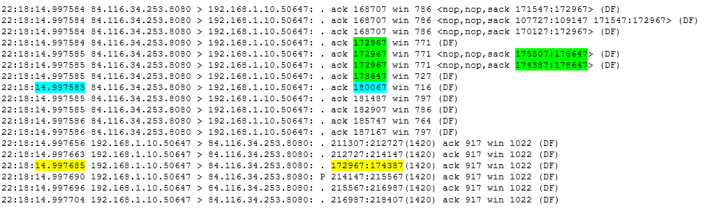

    At 22:18:14.967353 the byte range 172967:174387 is transmitted for the first time.
    Between 22:18:14.997584 and 22:18:14.997586 (30.231 milliseconds after the above and within a 2 microsecond period), 12 acknowledgements appear in the event trace (they have probably been "collected" by a lower level and then "indicated" as a group).
    At this point in the trace, one estimate of "Round Trip Time" (RackMinRtt) is 18.994 milliseconds. Either the three occurrences of 172967 as the next "unacknowledged" sequence number (simple duplicated acknowledgement threshold) or a combination of this with "recent acknowledgement" ("rack") timings suggest that a "fast retransmission" would be apposite. This happens before the next packet is examined a few nanoseconds later, showing that the "missing" byte range has been acknowledged.

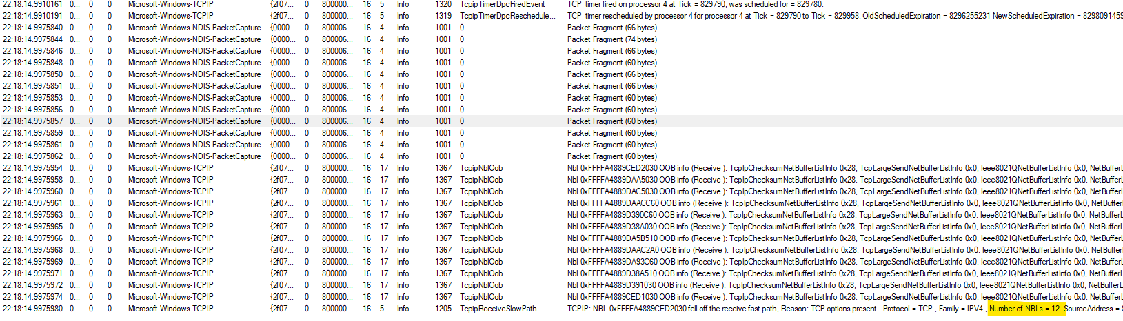

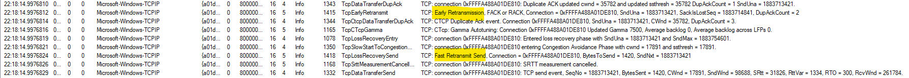

    These images of the Microsoft-Windows-TCPIP trace data show that the packets arrive as a group and that, subsequently, a fast retransmission occurs:
    It is the high degree of "out-of-order" delivery of TCP segments (i.e. segments that are not received in the same order/sequence as which they were sent in) which perhaps limits the number of users who experience this behaviour.

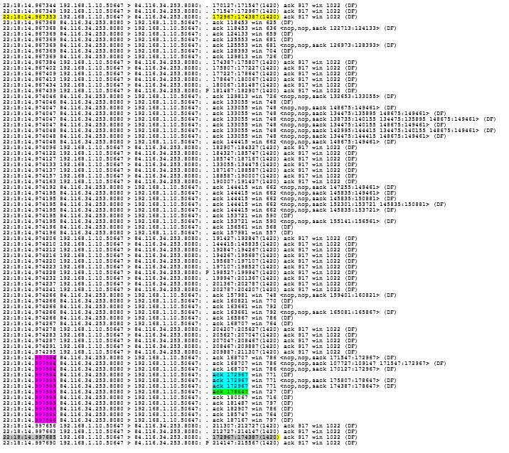

    I need to do some more checking to verify whether this is always or mostly the case, but I think that there are hints of the cause of the problem in the trace data. Here is a short extract:
    At some time before this extract, the 1420 bytes between 172967:174387 were sent from your system. In the extract above, we can see that the bytes up to 172967 were acknowledged and, initially, some bytes after 174387 were acknowledged with a "selective acknowledgement" (sack) - a warning that the bytes between 172967:174387 may have been lost.
    A little later (at 14.997585, highlighted in blue) the bytes between 172967:174387 are finally acknowledged.
    Now, very oddly, 100 microseconds later (at 14.997685, highlighted in yellow), your system retransmits the bytes between 172967:174387. If the timings in the trace are accurate and inferences drawn from the trace data match the Windows TCP/IP implementation's understanding of the state of affairs, there is no reason to retransmit the data.
    The retransmission of the data is not, in itself, a major problem but the fact that a retransmission was "necessary" causes the "congestion window" to be reduced. The congestion window is dynamically updated throughout the transfer but never increases to anywhere near the size needed to get the full "nominal" throughput of the link.
