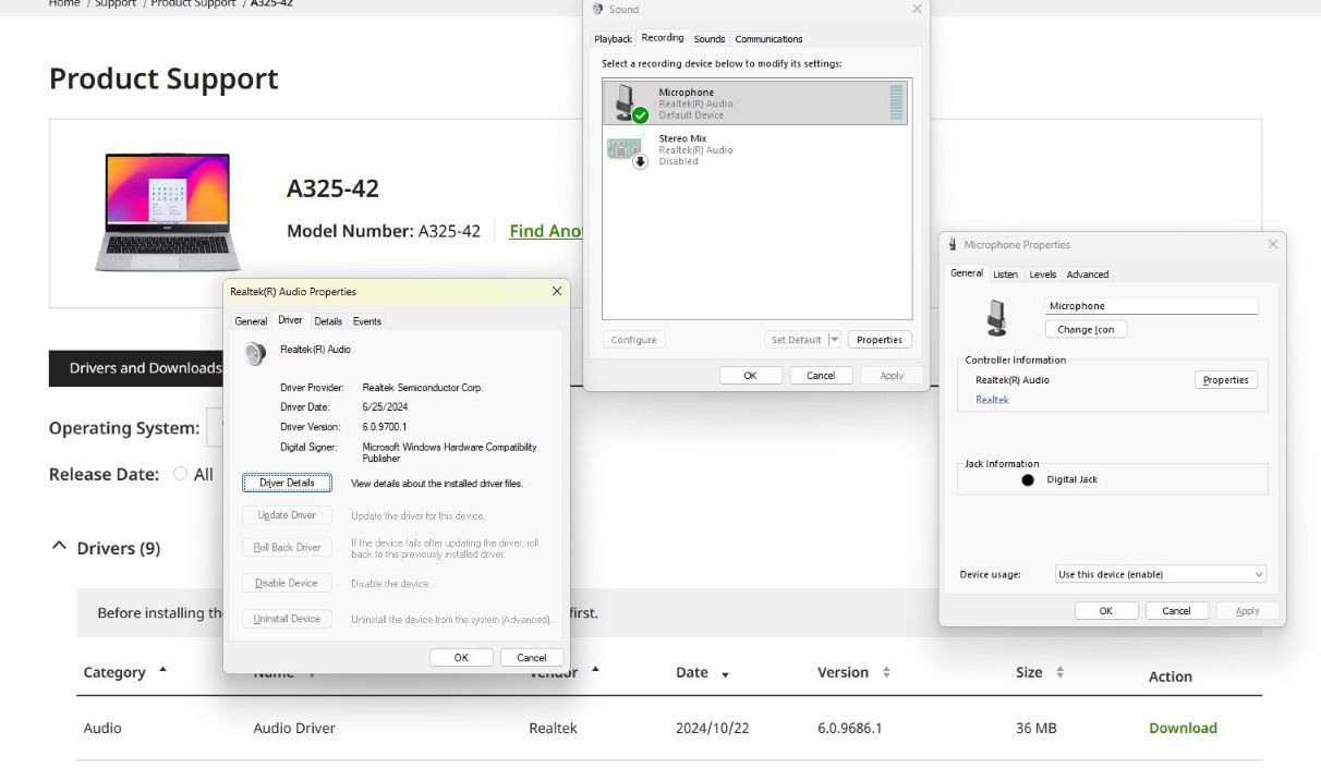

I've been facing this nagging Input Mic issue in Win 11 Pro machine ever since I bought this laptop.
Laptop Model: Acer A325-42 (AMD Ryzen 7730U).
Please see the image for the Audio info. acer
The problem: The Mic Input detects the Mic but it won't work.
Privacy>Mic: Access is ON; Let Apps access is ON.
acer-snd

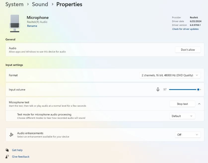

When I test the sound, the volume bar doesn't dance what I use Test, and it only records hissing noise!
I do not understand what's the issue here. The same Headset works perfectly with phones as well as tablet. I badly need this Mic Input function to work with a few Apps such as Duolingo etc on this Windows laptop.
Kindly guide me to resolve this issue.

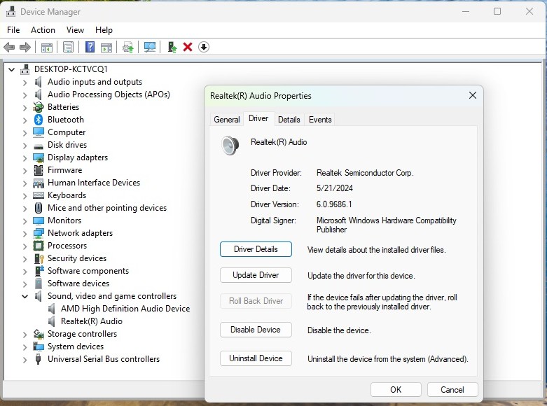

  1. Sunny Acer 0 Reputation points
    2026-09-14T15:35:18.0266667+00:00
    Hallo, Kai-H!
    I appreciate your response.
    Well, I was successful with the Acer OEM Realtek suite install, however the same hissing sound comes out. Please see the images.

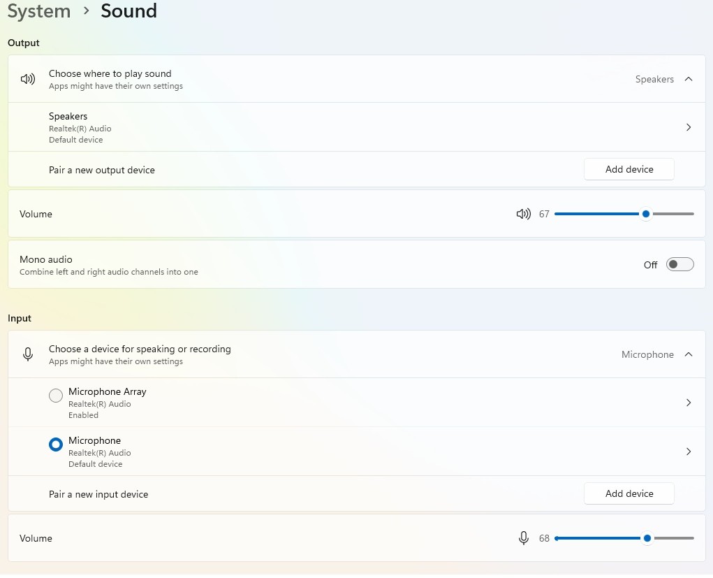

    Try Microphone Array In your Sound settings screenshot, there’s also a “Microphone Array (Realtek Audio).” Test that input — sometimes Acer maps the headset mic incorrectly under “Array” instead of “Microphone.”

    I also tried the Microphone Array (please see the above uploaded images). This time there wasn't any hissing sound either! A simple audio setup shouldn't give me this much pain. :(

  4. Kai-H 26,760 Reputation points Microsoft External Staff Moderator
    2026-09-14T08:53:39.4133333+00:00
    Hi, Sunny Acer
    The microphone is detected, but the hissing and inactive level meter suggest that Windows is receiving the wrong input signal. The screenshots also show a different Realtek driver version from the one offered for this Acer model.
    Here are some suggestions you can try:
    Disconnect the headset. Open Device Manager, expand Sound, video and game controllers, right-click Realtek(R) Audio, and select Uninstall device. If available, select Attempt to remove the driver, then restart the laptop.
    Install the audio driver listed specifically for the A325-42 from the Acer driver-download page, even if Windows previously installed a newer version.
    Note: This information is provided as a convenience to you. The site is not controlled by Microsoft. Microsoft cannot make any representations regarding the quality, safety, or suitability of any software or information found there. Please make sure that you completely understand the risk before retrieving any suggestions from the above link.
    Open Realtek Audio Console and, under Device advanced settings, make sure the analog jack is configured as Headset, not Headphones.
    In Settings > System > Sound > Microphone, keep Audio enhancements Off, select the microphone, and run Start test. Also confirm Let desktop apps access your microphone is enabled.
