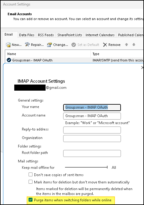

While trying to reset my password, in Outlook, file, acc' settings, acc' settings, change- the purge box was ticked and I didnt see what I wanted on the page so I clicked next.
I lost alot of emails and a couple of folders. In multiple folders emails were removed from current date back to about 2021, the older emails remained in the folder.

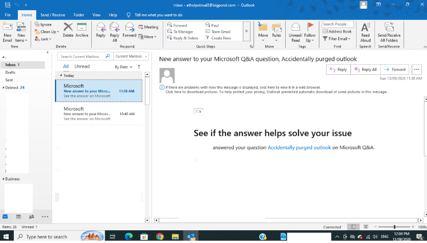

    First, I would like to confirm a few details to help narrow down the issue:
    • Are you using Classic Outlook or New Outlook? (If possible, please share a screenshot of the Outlook window).

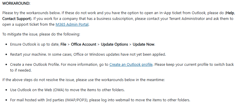

    About the error that you have mentioned, I found an Microsoft reference here:
    Outlook error "Cannot move the items" when moving items to other folders | Microsoft Support
    This will help determine whether Outlook is configured to download and display the full mailbox content.

    No I cannot see the missing emails in the bin/deleted or in Web mail account.
    My computer is about 8 years old and I'm still using windows 10.
    Yes the emails disappeared as soon as I hit next.
    The permission error is shown in the primary mailbox (and that's all we have), no other accounts and have never set-up forwarding options,
